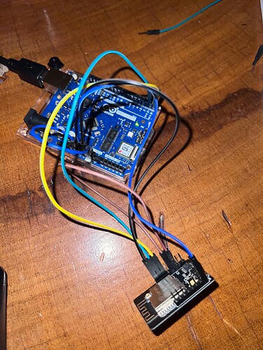

I am attempting to flash an ESP32-CAM module using an Arduino Uno as the USB-to-serial converter. Despite several attempts, I keep encountering a "serial exception error: Write timeout". Below is a detailed description of the steps I've taken, the hardware setup, and the scripts used in my attempts to solve this problem.
I have tried two hardware setups. One using a voltage divider between the RX pin on the esp32 to ensure that the voltage was at 3.3V this was using 2Kohm and 1Kohm resistor.
My suspicion is that the board itself is faulty. or my power supply from the arduino is not good. I have checked that by powering an LED. I dont have access to multi meter.
Hardware Setup
  1. ESP32-CAM Module
  2. Arduino Uno
  3. Connections:
  • ESP32-CAM VCC -> Arduino 5V
  • ESP32-CAM GND -> Arduino GND
  • ESP32-CAM U0T (TX) -> Arduino TX (Pin 1)
  • ESP32-CAM U0R (RX) -> Arduino RX (Pin 0)
  • GPIO0 -> GND (for flashing mode)
  • RESET (EN) -> GND on the Arduino (for resetting the ESP32-CAM)

I tried using the command prompt power-shell, I also got a write timeout issue.
It would be nice if someone could help me to see if I am making a hardware mistake or if my board is just faulty. I am also using a non standard USB for the Arduino. I have confirmed the Arduino flashes fine. Any help is welcomed, and appreciated.

Just buy a real USB <--> Serial converter and avoid the extra complexity of the Uno and level shifters. This one works great. It has 3.3V logical levels and a +5V output to power the ESP32-CAM via it's 5V power pin:
https://www.adafruit.com/product/954
