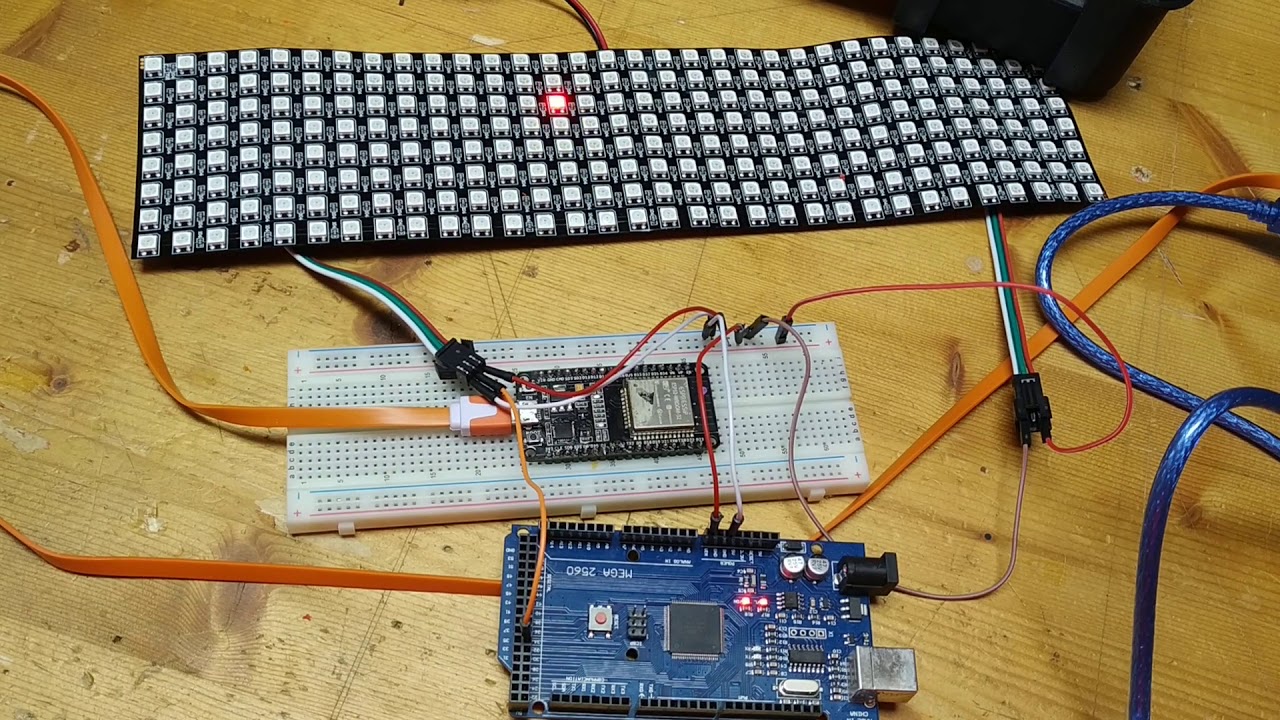

Hi guys,
I'm quite new to Arduino and habe spent the last two days researching stuff, testing demos/examples and so on.
I bought this flexible LED Matrix, because I wanted to make a simple digital clock with this. I know there are several, maybe better solutions with those MAX7129 Panels, however now I got this thing and I thought this wouldn't be difficult at all and that there might already be similar projects out there :slight_smile:
I seems I was wrong or I underestimated the difficulty. I got the time acquirement via ntp implemented, but with displaying content I have some issues. There are 3 problems which I need to address and I'm hopefully looking for your help.
Attached is the video which shows 2 of the 3 problems.
  1. I'm getting random pixels lid, which in my opinion shouldn't light up. A problem with the data line I guess? Too much noise? What should I do about this? Adding a cap oder resistor?
  2. The text which is displayed is "Instructables" but as you can see in the video, it is kinda hard to read because it looks like the text ist scrolling also up and down 1 pixel during the left/right scrolling. Not sure why this is. Maybe also caused by noise?
  3. The last and most frustrating problem so far is, that I don't want the text to scroll. I just want to display on a fixes position it and update every second. I haven't figured out how to do this. Either it is too simple or I'm just a retard :slight_smile:
If I remove the loop which is scrooling the text and enter a fixed position of the cursor, nothing shows up.
Here is the actual code:

what arduino are you using and how is this powered ?

It looks like you are using an ESP / NodeMCU of some sort and they usually use 3.3V logic. The WS2812 LED's require the logic voltage to be at least 70% of the supply voltage, so if the strip is powered by 5V, the logic must be at least 5*0.7=3.5V and this may be an issue. Also mind that the fully lit strip will consume (3 colors * 20mA per color * 256 LED's) more than 15A which requires a rather beefy power supply.

I uploaded your code and here's a video how it looks like:
The code itself is working but there are still some LEDs which are lighting up where they shouldn't.
What could be causing this?
@Danois90
I'm aware of this. I'm using a 5A Lab power supply. In 99% of all test cases the strip did consume less than 1A current on 5V. Only if all LEDs are lid up in all colors the current draw can be that high, which in my purposed used case will never be the case :slight_smile:
I'm not sure but I guess this is not the problem. With J-M-L test sketch the matrix draws about 300mah.
The thing with the level of the logic voltage beeing to low is interesting and might be an issue. What would be the usual way to get around this issue?
I have that display. I was able to drive it first time with an UNO. WS2812B timing is tight, I'm almost surprised that you can drive it from an ESP at all. Use a level translator circuit to get from 3.3V to 5V. Keep all your connection wires short and run the signal wires adjacent to the ground wires.
As long as interrupts are disabled while data is transmittet to the LED's, it is no problem using an ESP.
If you have one WS2812 laying around, you can actually use a nifty little hack to use that LED as logic level shifter.
Did you buy a quality component or a cheap version from Asia ?
Might have some poor connections in the matrix too...
Is it well grounded ? If you can from as many places as possible
The thing with the level of the logic voltage being to low is interesting and might be an issue. What would be the usual way to get around this issue?
I use 7400 TTL chips, WS281x are quite needy considering their logic high level, much more than 74xx00 series. If you are using an ESP, and you are planning to make use of the wifi capability, you should start using a different library to drive the strip. Neopixel.h only has a bit-banged method, which turns 'off' the interrupts for a while. This causes loss of wifi, really it won't work with wifi. Use Makuna/NeoPixelBus which has as a DMA mode which does not require interrupts to be turned off (only no more choice of pins. Now if the library that you use for filling the output buffer, actually write to the neopixel.h buffer or uses the functions that are included in it, you may need to modify that.
@aarg
I believe the voltage level logic is the problem. However the wires already are pretty short and should not be the problem.
@Danois90
Interesting! Will do this hack since I'd like to use this ESP32 (devkit v1) for this project
@J-M-L
Yes, it's a cheap knock off from Asia
Possible indeed, but in this case not the issue, see below :wink:
I think so. Added another ground line but no change.
@Deva_Rishi
Thanks, I already read about this library somewhere. Have to see if I'll be able to translate that with my knowledge.
@all
I made a simple test. I uploaded J-M-L's Test code onto an Arduino Mega 2560 and voila, the unsoppesedly lid up pixels are gone!
So the hint with the non matching voltage logic seems to be the issue and I'll try to use this WS2812 hack to make an level translator circuit and see how it works out.
Thanks a lot to @all so far, you really help out :slight_smile:

So I just implemented the WS2812 hack to manipulate the data line voltage, but now the unwanted effect is even bigger/stranger (before only some LEDs lid up, now with this hack they are additionally travelling some pixels).
Not sure why :confused:
One question still remains. Does anybody has a hint or even example code how to display a static text (not scrolling), with any LED Library?
I think the NeoMatrix library should do that for you in combination with the Adafruit_GFX, but of course only ready made in combination with neopixel.h. But it is not to complicated to tap into Adafruit_GFX. All you need to do is create a drawPixel() function (the vitual void in Adafruit_GFX)
Another option and probably even more straight forward is to delve into Adafruit_GFX and copy the method for extracting the pixels for every letter of a font, and map them to your matrix. This can be quite complex since GFX has Functions for every possible circumstance 1-bit 8-bit 16-bit etc, though you are probably after a 1 bit method, with set color. That GFX works with 16-bit color and you strip with 24-bit probably isn't helping. So nothing right out of the box, but custom made what probably be the easiest. You might want to use the adafruit glcfont.c, or you may want to you another font, still you will need to interface with it.
Just get a 5v TTL chip, i usually use a 74hct04 (or LS or whatever i have) and run the signal through the 'not-gate' twice, that does the job. I then generally make sure that the power of the hole circuit is well balanced, 1uf cap on the 3.3v line, 10uF on the 5v line and 100uF on the 12v line, and create a protective circuit for the ESP-01 with a few resistors and a diode (probably overkill since it's connected to a logic input, though i have fried several ESP-01's )
Good to see you nailed the issue - clearly if that works with the mega then the strip is ok
You’ll need to adapt voltage
If esp is an issue too, Did you check FastLED Light — ESPHome ?
Hey guys,
I got it sorted mostly I guess.
@Deva_Rishi
Thanks for the hint. This was the first try but it didn't work. It turned out that the declaration of the matrix was not proper, therefore the text was displayed in an invisible area.
I already ordered some pcbs from Ebay "I2C Logic Level Converter Bi-Directional Module5V to3.3V For Arduino" for 3€ and hopefully when the arrive they'll solve the logic problem the ESP32 has.
@J-M-L
Got it working now with the Adafruit NeoMatrix and GFX Librarys but will check this out for future projects maybe, thanks for the linlk.
Now for designing and printing a suitable case :slight_smile:
