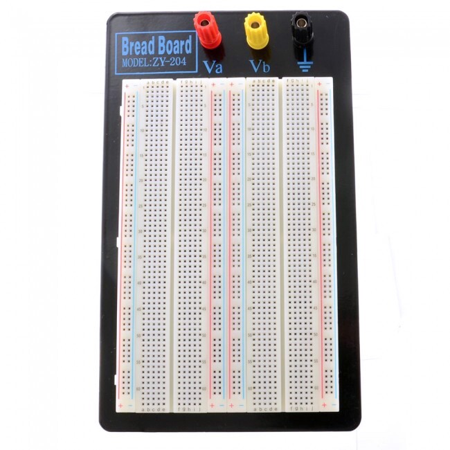

The absolute best whay to teach logic components, find a good schematic drawing program, have students connect and power a circuit on a solderless breadboard.
Wokwi has logic gates from which J/K and other logic functions can be assembled and simulated.
It's probably best without the Arduino. It needs to go slow, probably with LEDs so you can see what's happening.

For beginners or young students I'd say actual logic-chips and switches, buttons, and LEDs are best (and the most fun). Once you know the basics of electronics, logic voltage levels, etc., you can just look at a truth table or a datasheet.

Forget Arduino, get some logic gates and other stuff and let your students see what it does.
