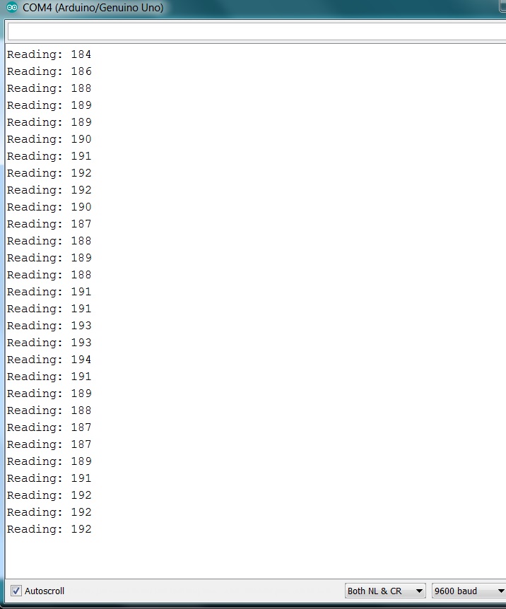

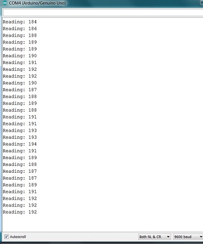

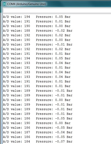

i have made same model what you have sent me. and also update my code with internal AREF.
Now ADC Readings are look like attached photo...!!
That's a lot of fluctuation, and it must be coming from the sensor.

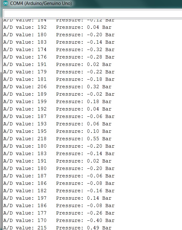

I have uploaded provided code to arduino.
Readings are as attached photo.

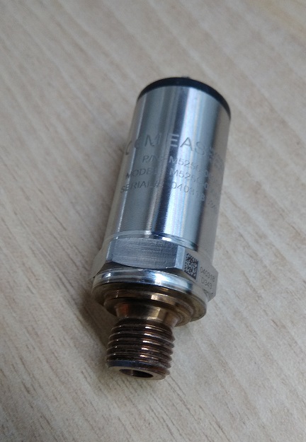

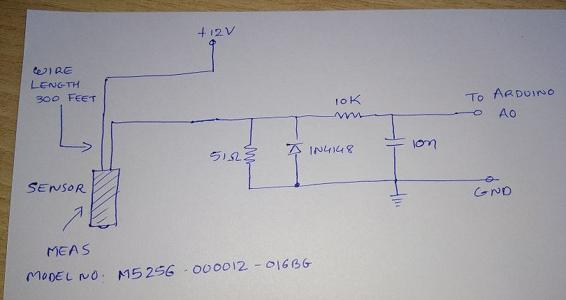

I am using MEAS made pressure transducer, MODEL NO. M5256-000012-016BG.
This is 16 Bar pressure sensor, i have attached photo of that.

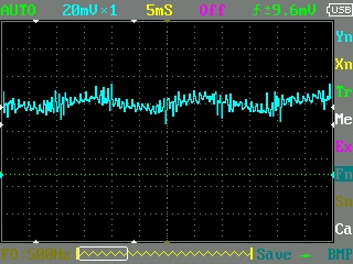

also i have connected CRO pins Between A0 and GND pin. Screenshot of that is also attached.
i have also attached connection diagram, please find in attachment.
Sensor A/D reading should not fluctuate more than one A/D value.
Is that 12volt sensor supply near the Arduino or near the sensor.
How did you connect sensor ground and/or 12volt supply ground to the Arduino.
How do you power the Arduino.
(I asked for a real picture of the setup, to check all of the above)
Is this used in a noisy (electrical) environment.
Did you use twisted or shielded cable (300ft can be a powerful aerial).
Do you see an improvement if you add a 100uF electrolytic cap across the 51ohm resistor.

I am using 12V DC SMPS adeptor for power supply to Sensor.
i connected arduino with my PC using USB Cable for power and serial communication.
No there is no any electrical noisy environment.
Actually i want to measure water depth inside ground bore-well and data logger, directly this pressure sensor is not able to for that i have covered my sensor with special corrosion free copper material to avoid damage due to high pressure. (sensor photo is attached).
i am not using full range of sensor, for 100 feet measurement span is only between 4mA to 6mA.
Not sure if groundloops are involved.
Did you test it with the sensor in the well or still outside the well (sensor not connected to water/earth).
Did you try the 100uF smoothing cap across the 51ohm resistor.
Leo..

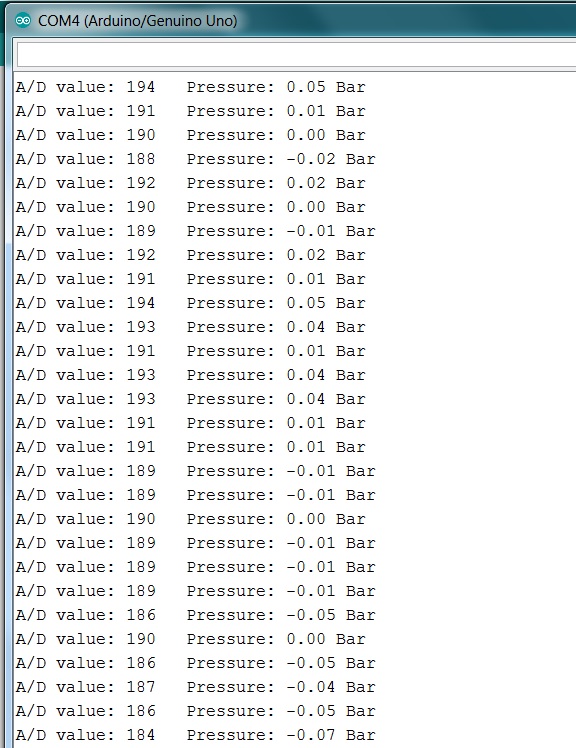

yes i have connected 100n Capacitor across 51 Ohm resistor.
but still ADC Reading is not stable.
i have attached ADC Reading after connecting 100n Capacitor across 51 Ohm resistor.
i have connected CRO output connected across A0 and Ground.

Read that post again. I didn't say 100n.
Try 100uF electrolytic (or bigger).
Remove if it doesn't help.

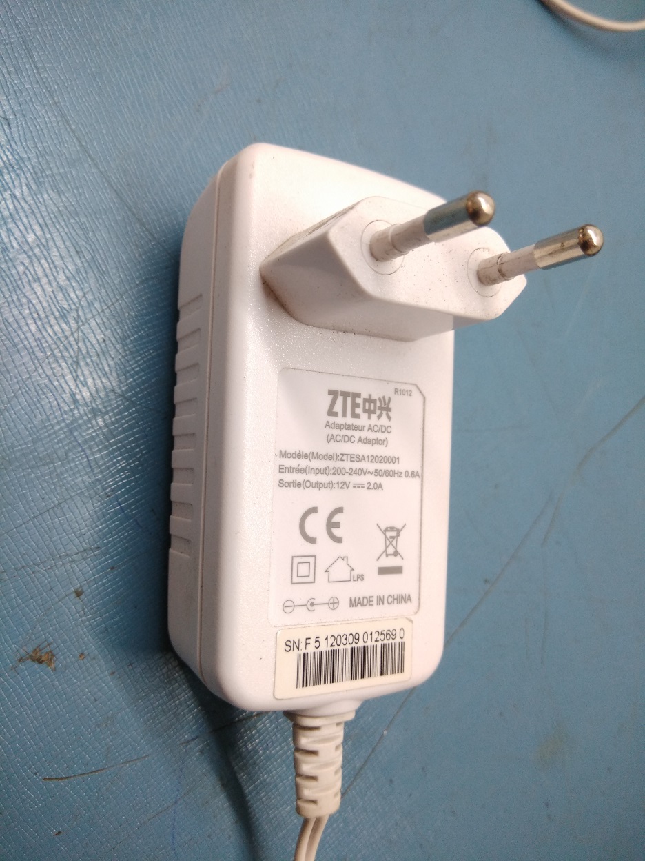

What sort of 12volt supply are you using .
Is it a small 12volt plug-in supply (no ground), or a grounded metal-frame supply.
Post a picture.
I am using 12V SMPS with no metal body.
please see attached photo of that.
