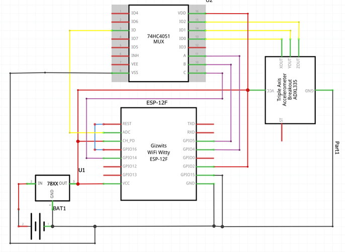

I've attached the current schematic. Doesn't include addition of the capacitor, which I think goes right between the regulator and VCC on the ESP?
I see you have used LM7805 symbol in diagram, cos fritzty doesn't have LD33v3, fair enough.
Do you have the associated capacitors around the LD33v3 to keep it stable, they must be mounted close to the regulators pins.
Tom... :slight_smile:
To be honest I'm new to the best practices with capacitors. My only plans right now are to add a capacitor next to the regulator, would you recommend others as well for this setup?

Capacitors go from IN to GND and from OUT to GND. Close to the regulator.
Page3/Figure4 has the minimum requirements for stable operation.
A regulator without those decoupling caps could oscillate, and give an unstable output voltage.
