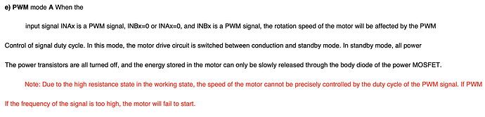

OK, so I managed to find and translate a datasheet, and it turns out the driver has a fast and slow decay mode. The default was fast decay, which apparently is known for lower torque and worse speed control. I just tried it in slow decay mode, and it's working like magic. Speed control is basically perfectly linear, and it has good torque even at low RPM and low PWM.

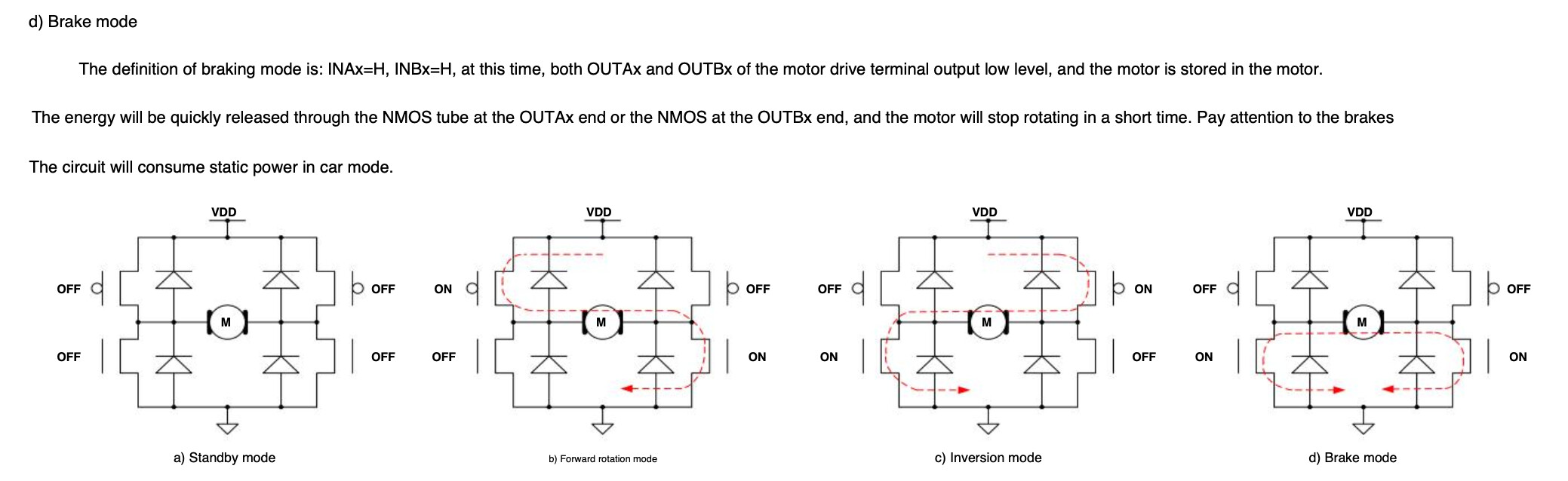

Fast decay in this instance = the driver leaves the mosfets floating during PWM off time, and the excess current flows through the body diodes of the H bridge, theoretically back to the power source. When going from 100% to 0%, this allows the motor to coast.
Slow decay = the driver shorts the motor pins together during PWM off. This mode also stops the motor almost instantly when going from 100% to 0%, as the shorted motor brakes itself. Hence why it's confusing to me that this mode also increases forward torque during low duty cycle PWM, as intuitively I'd have thought that the motor would be braking itself during PWM off and "fighting" itself, as opposed to increasing torque.

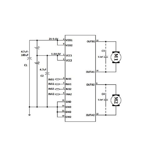

Can you please redraw your schematics using the correct pinouts.
You show themotor connected across pins 5 and 6!!!!! the data sheet shows 9 and 12 or 13 and 16.
PLEASE an image of a hand drawn circuit will be fine.
Please include component names and pin labels.
Yeah I was using the chip in the diagram as a black box example, not intended to represent my actual layout. IRL I'm using the exact layout as shown in that reference diagram. The question isn't about how to use the driver, but more specifically about why the motor torque increases when running the driver in slow-decay mode, or when running a single flyback diode across the motor.

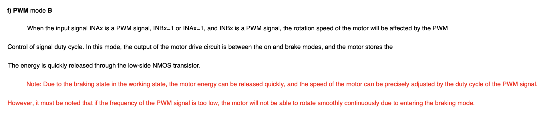

The driver is put into slow decay mode by holding the other direction control high all the time, so during PWM off time both forward and backward are high (the driver specifically supports this), and during PWM on time, only one direction is high and the other is low.
This makes the PWM control inverse, where 0 is full speed and 255 is no speed, but that's not a problem.
Here's the relevant screenshots from the translated datasheet in case it provides clarity:
PWM Mode A is fast decay.
PWM Mode B is slow decay.
