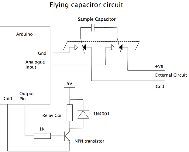

Here is one using MOSFETs, it shows the basic structure.
Can you explain this circuit? I can't make sense of it.
  • What does it do?
  • How are the MOSFETs driven?
  • Given the apparent mid point of the ground it seems to have a split power supply but this isn't clear.
  • What is the point of having 2 or 3 capacitors in series?
  • How does it form a flying capacitor circuit?
So you can monitor each individual cell in a battery.
This is my diagram and I will not re-post it here.
If you want more capacitors just duplicate what you have here. That is simply more capacitors and more relay drivers.
Do you understand the function of the dotted line? It is to show that the relay is a double throw relay.
The sample capacitor need to be only about 1nF.
This is as good as it gets try expanding it to two capacitors and post your interpretation of the expanded circuit for us to check here.
Is there a reason why you want to build this from scratch using relays rather than using a battery monitor IC?
Mike, I know what is trying to be achieved and I know how to do it with relays and one capacitor, but I don't have a clue how that circuit is supposed to do anything, let alone monitor battery voltages. I'm hoping it's genius and I'll learn something, but right now I can't see it.
Me neither.

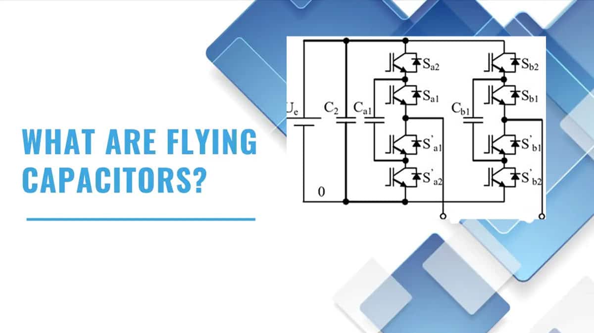

This might help:
https://eepower.com/technical-articles/the-flying-capacitor-boosters-capacitor-sizing-balancing-and-pre-charge/#projects:programming
These links will explain it better then I can.
@gilshultz ,
The 2 Web pages you linked to in post #14 are interesting and have taught me some things I didn't know about using flying capacitors in inverters, they offer nothing about what the OP is asking about, which I quote below as a reminder:
If the circuit in post #8 can be used for the OP's purposes I, and I suspect the OP, am still puzzled about how that would work.

Maybe this explains it better!
No, that is a multi level inverter which uses flying capacitors for an entirely different purpose.
