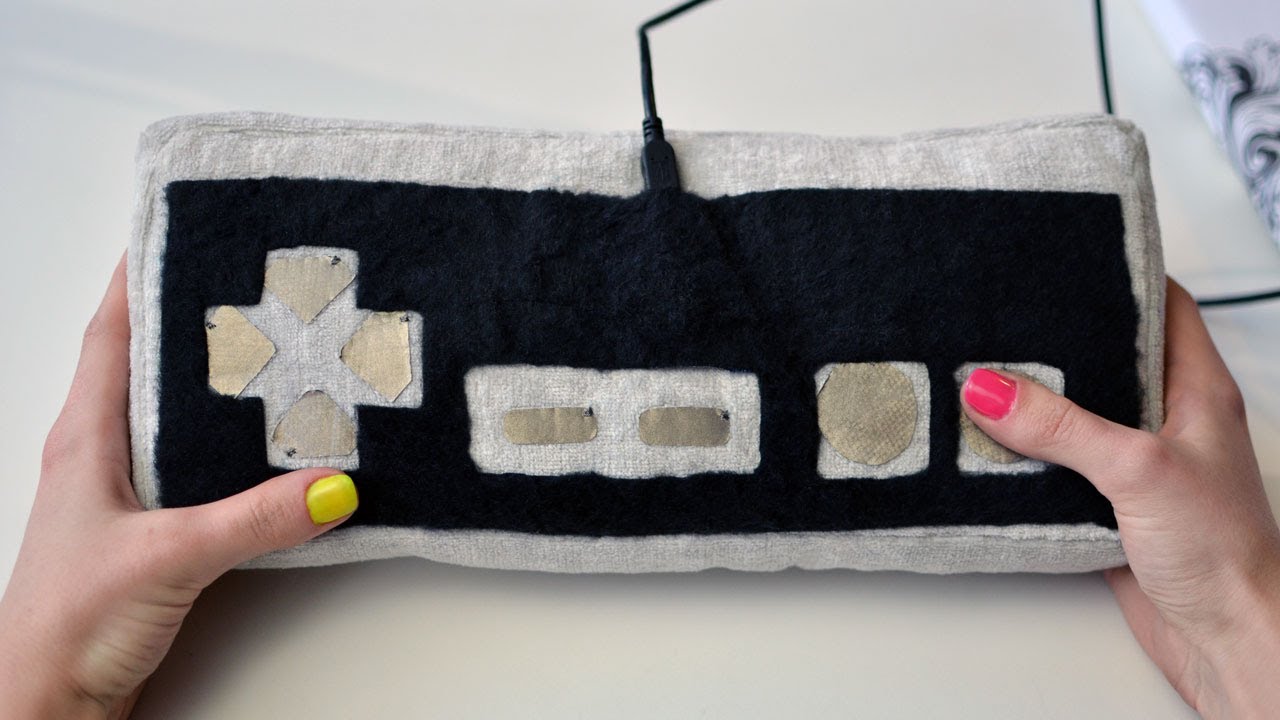

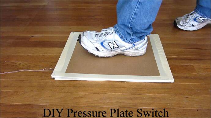

A mat that detects if something is on it ? Well, yes, some make a DIY switch, either with conductive thread or conductive fabric, sometimes in combination with a capacitive detection instead of just a contact.
Here are some ideas:
How long will those DIY switches last ? I don't know, but I doubt it will be reliable.
