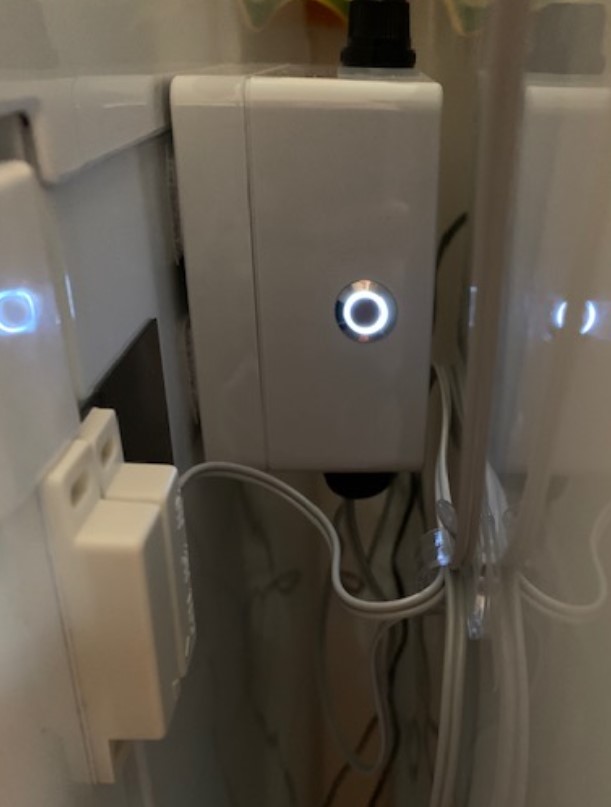

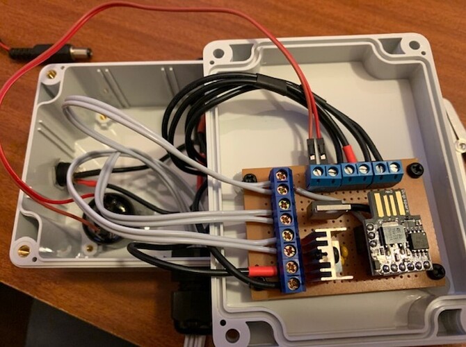

Hi Community,
I have built a fridge door alarm using an ATTiny85 Digispark, it works as expected with the exception of a single call of the buzzer function piezoBuzzer(); five minutes after a door is opened and closed which is driven by the long tps_before_activation = 300000;.
I based it off some code from intructables: https://www.instructables.com/id/Fridges-door-alarm/ and modified it to suit my needs.

The intended goal is to have it beep continuously after five minutes to alert me that a door is open with the ability to press the test button (pin 4) to test its alive.
I am pretty sure it is a logic issue that I am not seeing as to why it is waiting five minutes in the code to produce a single beep after a door has been opened then closed. I would like it to still retain the test button on pin 4 to ensure the thing is alive and running the loop.
Thanks for having a look!

Hi Community,
After having a good friend look over my code, he suggested most of what you have all pointed too. He is an Electrical Eng. and uses Atmel's AVR Studio for his programming, which is a whole level again for a poor Civil Eng. like me :confused:
I must admit, I used an example and put too much trust in the existing logic and thought I had enough understanding for it to work when the delay was set to 5 seconds during testing.
I agree with all the comments made, oh and yes I have pull-down resistors on the input pins. As for the millis suggestion, it was one of the first ones my friend had made and he had suggested this site: http://forward.com.au/pfod/ArduinoProgramming/TimingDelaysInArduino.html
I am pretty confident the boards wiring is correct and will try to write something from bare bones and include the millis instead of the delay.
Many thanks for your review and suggestions!
