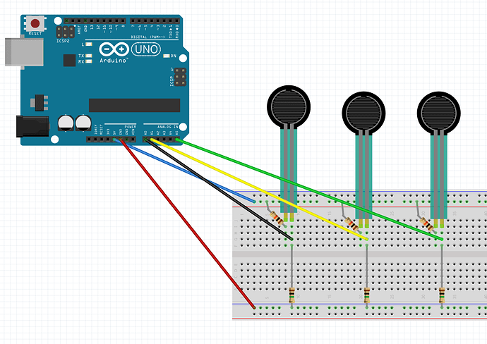

I'm working on a project that requires me to use several different FSRs. I have successfully plugged in 3 of the FSR's into my breadboard and written code to output the three values however when I touch just one FSR, I get outputs for all three.
For example, I have FSR A, B and C.
If I touch FSR A and just FSR A, I get a ready (say 700). FSR B will then output a smaller value (say 400) while FSR C will output an even smaller value (say 50).
Any idea as to why this may be happening?
Sounds like your analog inputs are floating.
Post a schematic showing how everything is connected. Hand drawn is ok.

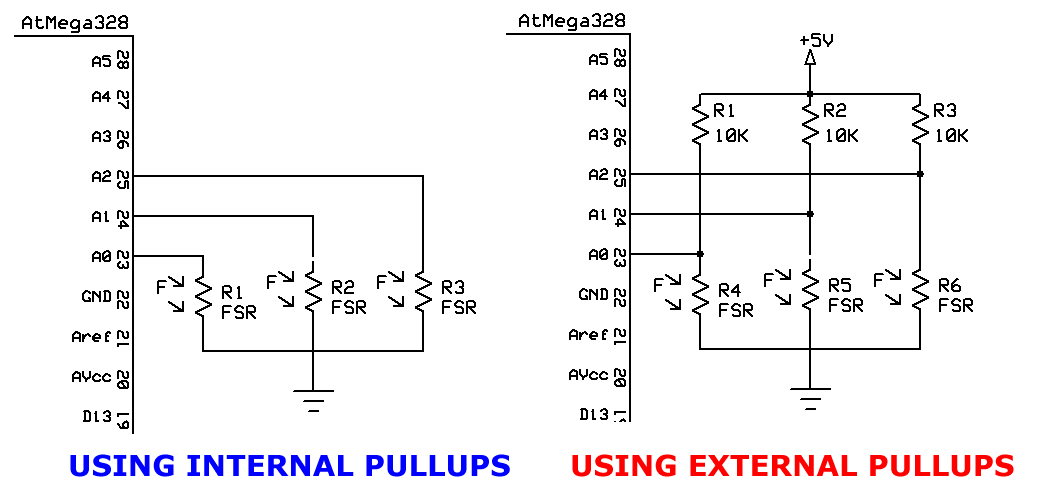

Each FSR requires its own load resistor. You can use the internal pullup on the analog input as the load resistor if the yields sufficient sensitivity.
Here is example code for using the internal pullups.
// using internal pullups for FSR load R.

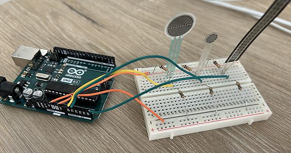

Thanks so much for taking a look. Here are two images:

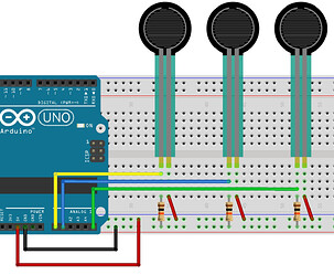

I've attached two images. One of the literal board and one of an schematic I made on Fritz. (I'm relatively new to this if you couldnt tell).
For further insight I have three different FSR's and im running 10k from power to the FSR and 1m to ground. Im fairly certain I'm using the wrong resistors.
This is so helpful, thank you so much for taking the time.
Here are two images: one of my board and one schematic. I'm fairly certain that i'm just using the wrong resistors (im very new to this).

It is hard for me to see what goes where in the photo. Sorry, old eyes. Terminals are not labeled. A schematic would be less ambiguous.
The 2 terminal FSRs need only 1 load resistor. 10K is a reasonable value.
The 3 terminal FDR probably does not use a load resistor. it would be wired like a potentiometer. It looked like 3 terminals, but I blew it up and now see that it is 2, Sorry for the confusion on my part.
Is this image more helpful?
You are connecting the analog inputs to the wrong places. The 1M resistors are way to high in value to be of any use.
I hate Fritzing but will try to show how to wire the FSRs. Only 1 resistor needed if you use external resistors. No resistors needed if you wire the FSRs to ground and use the internal pullups.
One side of the FSR goes directly to Vcc. The other side goes to ground through a 10K (or so) load resistor. The analog input connects to the junction of the load resistor and the FSR terminal.
Or one side of the FSR goes direct to ground. The other side goes to Vcc through a load resistor. The analog input connects to the junction of the load resistor and the FSR terminal.
