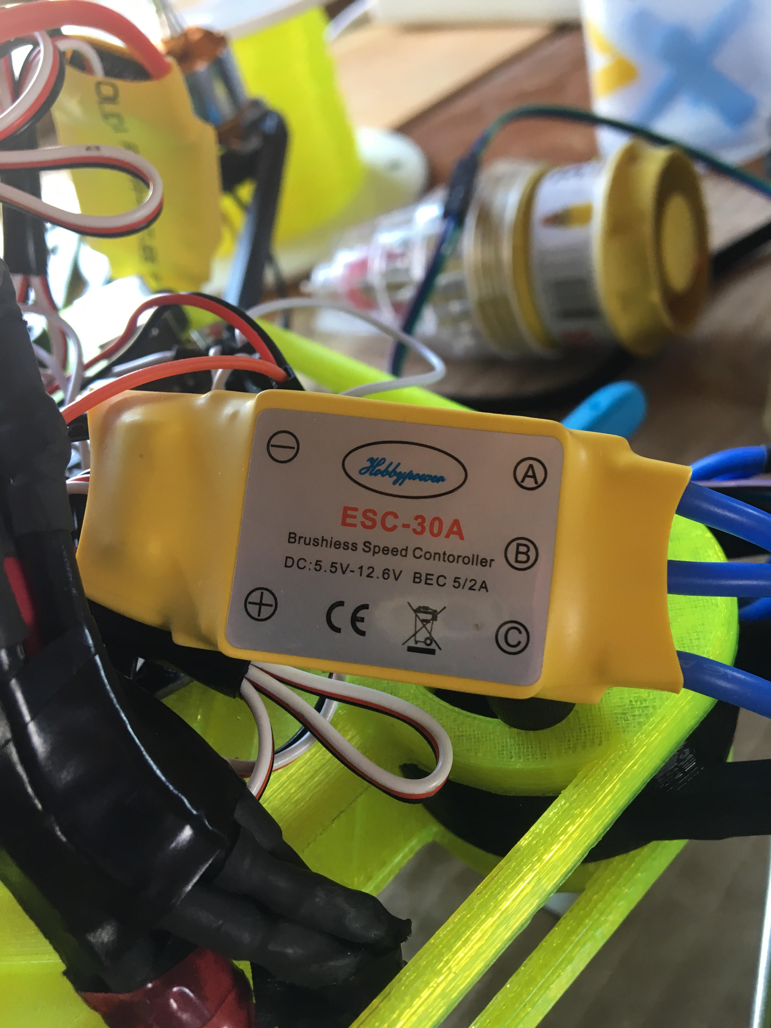

Hello everyone I am in the process of making a quad copter out of just an arduino and what I mean by that is I have an MPU I plan to use the brains of it all will be an UNO R3, I am building my own controller. I do not want to use someone else's software like multwii. I wanted to make a bare bones flight controller from the arduino IDE After tons of research I have only found one other person who has done this. I have tried to study his code but there is not much documentation to it and threre is not much comenting well not enough for me to understand. I am fairly new to arduino I would say I've been messing around with it for 3 months and what better way to learn arduino IDE than to take on such a big project...Yeah, I understand I am insane.
Never the less I would really appreciate if you all could look at the code that I have written and give me some feed back. I have been able to tie my drone down and get it to lift off the ground about 7in~18cm off the ground. I have been able to make it roll to the right and pitch forward both were in different variations of code and then I tried to make it so i can pitch and roll to either side and now... Nothing works. Now all I can do is get it to lift off the ground. I am trying to fix this at the moment. This is as close to the code I could get to when I could make the drone Pitch forward. I think I have the code pretty well commented. and I have pictures attached. If you have any questions let me know. As of right now the joysticks are hardwired to the UNO R3. I also have not yet implemented the MPU.

It would be much simpler to calculate your base 'lift' value from the throttle on A0, and modify this per motor depending on the values from pitch (A1) and roll (A2).
E.g. assuming that positive 'pitch' reading means tilt forward, and positive roll reading means tilt right (some mapping of input values would be required to achieve this of course).
M1 (front left) = lift - pitch + roll
M2 (front right) = lift - pitch - roll
M3 (back left) = lift + pitch + roll
M4 (back right) = lift + pitch - roll
This will also allow you to pitch and roll at the same time which it not possible in your code.
It's probably worth starting with the gryo/accel part of things though without it I think you will struggle to fly the quadcopter at all.
There are many examples online of people doing this (assuming I understand your aim correctly) if you search for 'diy arduino flightcontroller' or 'arduino flightcontroller from scratch' or something like that.
For your fully-manual flight controller the code would look like this:
