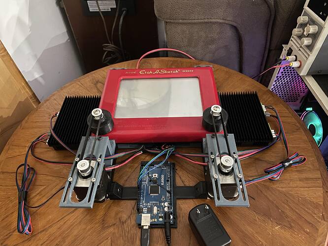

Hello,
I've built this little machine and I'm trying to code it to learn some skills and what not. I don't want to use GRBL so I'm trying to set up my own code to do this.
Ultimately my goal is to create a function I can draw a line directed at a given angle 0-359, and a given length.
Something like: drawline(angle, length)
At this point my goal along the way is to drive two stepper motors in a near simultaneous way instead of moving motor#1 by distance_a and motor#2 by distance_a. I assume the only way to do it is by moving each motor by 1 step followed by the next motor, back and forth.
Ive used this link:
Arduino Stepper Doc
But I can't figure out how to drive them simultaneously so thats why I'm going about it like this... I'm trying to make a function with these arguments: drive(motor, speed) such that drive will return one single step from the chosen motor. Using this single step function I will loop it as I did.
Please and thanks for anyone's help.

My motor is wired like this:

Your problem is the stepper.h library. All stepper movements of this library are blocking. So you cannot move two steppers at the same time simultaneously.
Use another ( non blocking ) stepper library . Or create the steps without a library at all.
If you don't need acceleration, the multistepper part of the AccelStepper library may be a solution.
Or learn to use direct port manipulation, that's how I would start.
At any angle other than 45°, you need to drive one motor more steps than the other, so they can't all be "simultaneous" or paired.
You don't need a function to drive a stepper moter by one step, you already have that in drive(). What you need is a function to decide whether or not the slower axis needs to take a step or not.
Take a look into the Bresenham Line Algorithm for scheduling whether the axis with slower stepping needs to do a step or not.
The trick is figuring out which axis needs more steps, and each time you to take a step, decide whether or not the other axis also needs a step. The Bresenham algorithm does the ratio math with repeated additions and subtractions so it is fast and precise.
CNCs and 3d printers use the algorithm to coordinate motion between axes.
