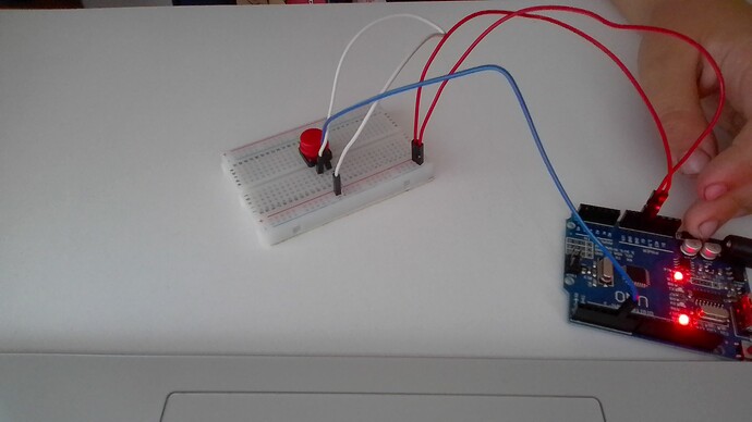

im trying to make a controller to play the chrome dinosaur game.
my board is uno r3

i only have buttons lights and wires
this board can't be turned into HID Keyboard device
your board is "Arduino Uno R3 compatible CH341 clone"
oh, thanks for telling me, i have been searching the whole internet
Even if you get this working you are going to be disappointed as soon as the game turns into "night" mode. In that mode, instead of sensing the obstacle the LDR will sense the dark background and the dino will jump immediately
It would be possible to sense the change to "night" mode and reverse the obstacle sensing to look for white objects but how complicated do you want to make this ?
Another problem that I foresee is that the dino jump timing has to vary with the speed of the game which the code does not do
I hope that you don't think that you are going to set any records using this project, but good luck with it
