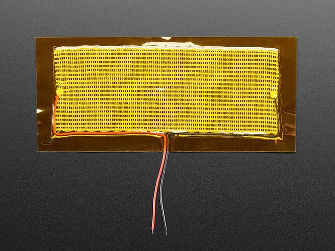

These heating pads are great:
I’ve run them at 10 and 12 volts.

PTC Heating Element
Go to Amazon and search for:
arduino heating pad
Cool heating pad, uhm I mean Hot!

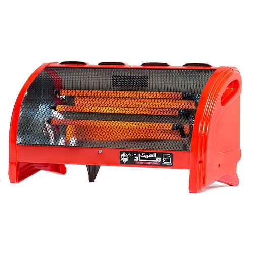

Where I live heating elements like this:
Are available. They're used in these kind of electric heater and work with 200v AC:
There are also heating elements available that work with 12v and are used for car seats. And also heating elements for electric blankets.
