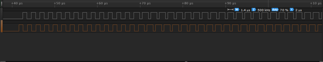

Generating 180 degree phase shifted PWM waves
Hi all, I am trying to generate two 180-degree phase-shifted PWM waves. However, my proposed code's wave time period is off by a factor of 8. Also, the code abruptly stops responding for frequencies greater than 200 kHz (Frequency index >7).
My code:

Search the forum for already discussed and implemented hardware solutions.
That code has a sort of ChatGPT look to it.
You appear to want to vary the frequency in the range 40 to 900 KHz and duty cycle with in from 10 to 90%, want additionally a 180 degree phase shift. Are you free to user other pins than the ones defined in your sketch ?
What board are you using ?
Hi, I am using Arduino Uno right now. All the pins are also free.
These comments are wrong. Did you write them? I did not look any further to see if there are other code errors.
Avoid use of Strings. They cause program crashes and unpredictable behavior on Arduinos.
Apart from the prescaler problem already mentioned, which could explain the "factor of 8" problem, you also have a problem here. digitalWrite() takes a few microseconds to execute. Per wave, digitalWrite() is called 4 times. Also an ISR call takes a few microseconds. This will limit the maximum frequency and accuracy of the duty cycle. Under these circumstances, the 200 kHz you say that you have achieved actually sounds high. You'd best look a fast PWM mode on timer 1, which directly manipulates the pins. You may have to use a transistor or similar to provide the inverted signal. You may get some improvement using direct port manipulation instead of digitalWrite() but nowhere near the 900 kHz mentioned in the code.
Have you an oscilloscope or logic analyser to check the output?
EDIT
Here is an example of using timer 1 in fast PWM mode with control over both the frequency and the duty cycle: Gammon Forum : Electronics : Microprocessors : Timers and counters
The core of it is very simple and note that there is no ISR and no explicit pin manipulation.
You said the program becomes unresponsive on reaching a certain frequency. Once the interrupts take 100% of CPU capacity, the loop() is no longer serviced.
Makes sense. I'll again check my output using an oscilloscope. Thanks for you feedback.
To get the 180° phase shift you will need to use two timers. There is an option to synchronize timers so by setting the TCNT of one timer to zero and getting the TCNT of the other to TOP/2 you can start them 180° out of phase. Since they run off the same system clock they should stay in sync.
Because there is only one 16-bit timer you will be limited to 8-bit PWM. I think you might have trouble with prescale since Timer2 and Timer1 have different choices of prescale factors:

Try this. It compiles for Arduino UNO without error but I have not checked the outputs (Pin 10 and Pin 5)
// Generating 180* out-of-phase Variable-Frequency PWM on
// Timer1 and Timer2 of an Arduino UNO (Pins 10 and 5)

  TimerTOP = top32;
  OCR1A = TimerTOP;
  OCR2A = TimerTOP;
  // Since TOP might have changed...
  OCR1B = (PercentPWM * (uint32_t)TimerTOP) / 100;
  OCR2B = (PercentPWM * (uint32_t)TimerTOP) / 100;
   // Freeze the prescale counters on Timer1 and Timer2
  GTCCR = _BV(TSM) | _BV(PSRASY);
  TCNT1 = 0;
  TCNT2 = TimerTOP / 2;  // 180° out of phase
  TCCR1B |= prescaleBits1; // Set clock prescale bits
  TCCR2B |= prescaleBits2; // Set clock prescale bits
  GTCCR = 0;  // Unfreeze the prescale counters

After 5 seconds, I changed from the default 1000Hz / 50% duty cycle to 500,000Hz / 70% duty cycle.
  static bool run = true ;
  if ( millis() > 5000 && run ) {
    run = false ;
    FPWM180SetFrequency(500000UL) ; // any time to change the output frequency
    FPWM180SetDutyCyclePercentage( 70 ) ; //  at any time to change duty cycle
The frequency changed OK. The duty cycle and phase shift don't look so good
. . . but seem to improve slowly !!
In a Phase Correct PWM mode the output pulses center around TOP (or BOTTOM if you like). 180° shift means inverted signal and complementary duty cycle on the second channel.
That should be: GTCCR = _BV(TSM) | _BV(PSRASY) | _BV(PSRSYNC);`
PSRASY only does Timer2, PSRSYNC does Timer1 and Timer0.
it is possible that the calculations based on TimerTOP should be based on (TimerTOP+1).
Clearly, there is still some scope for discussion about what a 180 degree phase shift means in the context of a PWM signal. In the case of sine wave there is no discussion. But what if the OP had asked for a 90 degree phase shift for his PWM signal? I don't think a simple inversion would have handled it.
Anyway, I've applied the latest changes
and since I have got the hardware still sitting on my desk, I gave it a spin. It looks good and clean.
Start with default 1kHz 50%
Transition to 500kHz 70% part 1
Transition to 500kHz 70% part 2
Transition to 500kHz 70% part 3
Final 500kHz 70%
