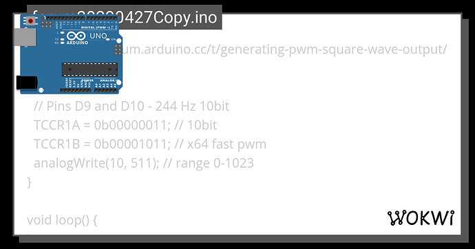

This link offers a cheat sheet for changing PWM frequency and takes a hybrid approach ... just changes the registers that affect frequency then use analogWrite to set the duty.
See if this does the trick :
-jim lee
Yes, that made it work. Thanks very much.
