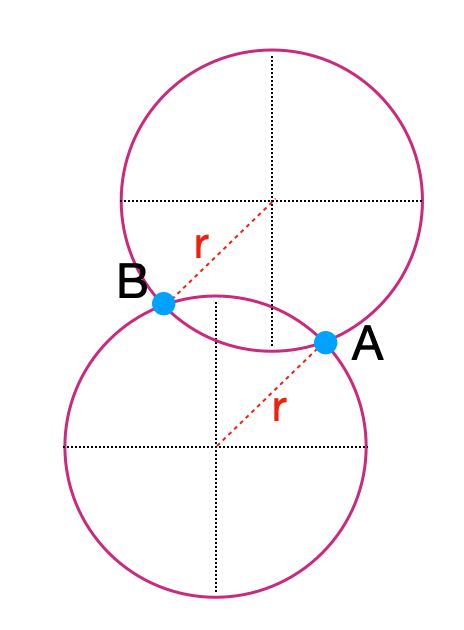

Two points and a radius ➜ 2 circles

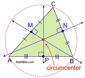

When you have three non-collinear points in 2D, there is exactly one circle that passes through all three points , it's called the circumcircle, and its center is called the circumcenter ➜ the circumcenter is the point where the perpendicular bisectors of the sides of the triangle formed by the three points intersect. The radius of the circumcircle is the distance from the circumcenter to any of the three points.
