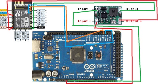

I've seen some things about people saying they needed to change the BAUD rate but I'm not sure how to do that without buying additional parts (which I don't want to do if I can avoid it) so if that is the case that I need to change it to 9600 instead of the 115200 then if someone could point me in the right direction as to how to change the BAUD rate with AT commands straight from the board that would be awesome.
my WiFiEspAT library is better, because it uses features of newer AT firmware versions.
so if you can update to AT 2.7.5 (SDK 3.0.5), use WiFiEspAT library
https://github.com/JAndrassy/WiFiEspAT#Why-a-new-wifiesp-library
I can't seem to run these on a Mega. Is this what you mean by update to AT 2.7.5? Can you elaborate further on that?

Ah, I did not! I thought I could just grab the Git and move it into libraries and roll, guess it also installs some dependencies when doing it through the Manager?
Well I was able to upload ect. now but I am getting the "Communication with WiFi module failed" message.
Since my current hook up works with the other library, presumably I have it wired correctly, yes?
I have it on a Mega in the 18/19 ports so I removed the If/Else statement to select a BAUD rate and just left this
#define AT_BAUD_RATE 115200
But no go with that. Any thoughts?

old AT firmware. it doesn't have the new command AT+CIPRECVMODE
Is there anyway I can update it through an Arduino without buying some kind of boot loader or something?
if you upload the SerialPassthrough example (wit baud rate changed to 115200), it will bridge the esp to computer.
for the esp to go into flashing mode io 0 of the eesp8266 must be LOW at reset or power-up.
you can download the SDK with the AT firmware here https://github.com/espressif/ESP8266_NONOS_SDK/releases
the upload command is
esptool.py write_flash --flash_size 2MB-c1 0x0 boot_v1.7.bin 0x01000 at/1024+1024/user1.2048.new.5.bin 0x1fb000 blank.bin 0x1fc000 esp_init_data_default_v08.bin 0xfe000 blank.bin 0x1fe000 blank.bin
you may have to install esptool.py https://docs.espressif.com/projects/esptool/en/latest/esp32/installation.html
Well, hopefully I don't blow anything up! I'll give it a shot haha. Never flashed anything before but we'll see.

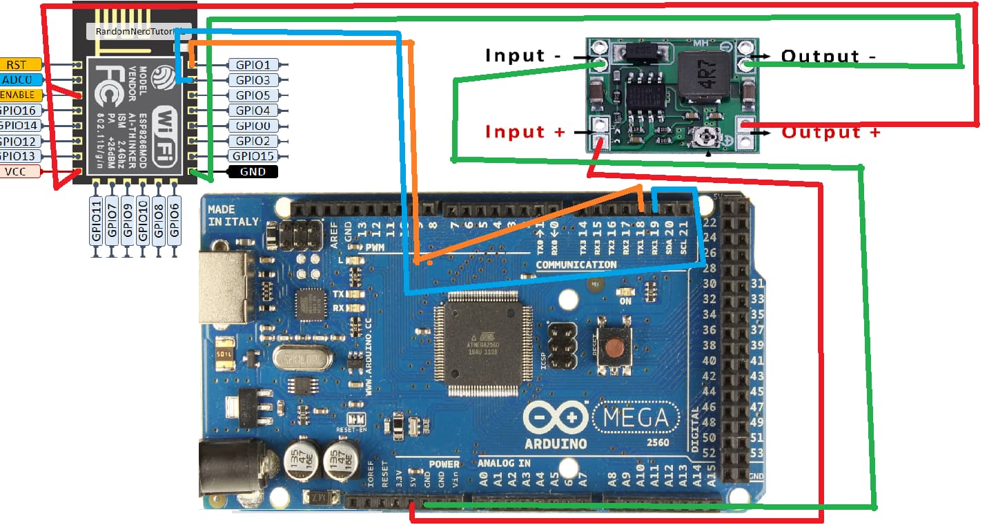

Here is a very rough demonstration of my wiring. Are you saying I need to remove the Enable pin while flashing?
So I removed the D0 and uploaded the sketch and then after powering up I pressed the RESET button the ESP and on the serial monitor I got a LONG string following by a "ready" but then typing AT for a test it errors out. Image of output shown below, the long string of illegal characters is about 3-5x as long as shown below.
sorry, I meant the SerialPassthrough basic example from IDE Examples menu. but this one will work too.
the unreadable part is the boot log at a different baud rate. it is not important.
when io 0 is wired to ground, AT firmware shouldn't start.
IO 0 (I assume you mean the ENABLE one from my example schematic) is generally wired to +3.3V
I removed it for now, but I get that "ERROR" when I type AT. Is that normal?
So this is my current wiring, when I get the ERROR message
io 0 is labeled GPIO 0
Okay, I got you now.
So this will be my wiring now. I'll get Python installed and flash it tomorrow and we'll see how it goes!
