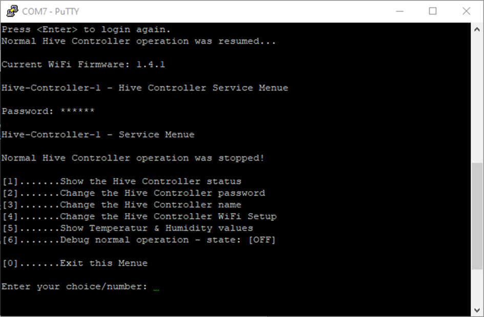

Dear ubidefeo, thanks for your answer!
First regarding the thingProperties.h and the browser refresh. I have test again and you are right, the contents of thingProperties.h stays in place as log no changes are made on the create thing properties…
Now to my code. Maybe in the future I will sell my project (Bee Hive monitoring/controlling) to customers - hopefully. And therefore, I need the possibility to save some credentials in the SAMD flash of the Arduino MKRs. I know that the flash will be flushed during uploading of a sketch, but this is not problematic for me.
When the Hive Controller was first powered on the customer must enter a password, the controller name and the WiFi Setting by using the CLI on the serial port. Later a “Service Menu” let the customer change the password or the WiFi SSID/Key or debug the controller. I have also implemented a session timeout and some code to "factory reset" the Controller if the customer forgot his password.
My code already works, but I am unsure if this was a good idea push the WiFi credentials with the function MyNwCredentials to the thingsProperties.h. What do you think?
Thanks in Advance
Andreas

@andreas_waldherr
I love the CLI approach over serial, I was about to suggest it and quickly reading through yours it looks well implemented and functional.
This is a good way to update the SSID and PSK but I'd suggest you a different approach which is easy to implement and won't be affected by the changes in thingProperties.h
You can create your own WiFIConnectionHandler and completely ignore the one that is created by default in the properties file.

Dear ubidefeo!
I have published my Serial Service Menu (CLI) shortly. Her is the Link: https://create.arduino.cc/projecthub/andreas_waldherr/serial-service-menu-91c5c1
I tried to use this command in my sketch:
WiFiConnectionHandler MySavedConnection(Setup.ssid, Setup.key);
but I ran into troubles when using this command from the void setup() function. The Arduino hungs. After resetting the the CPU everything works good, but I could not find a solution...
No problem, I used my void MyNwCredetials(String MySSID, String MyKEY) function...
Cheers
Andreas
