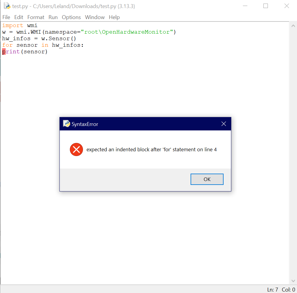

So it didn't work and said it was an invalid internal or external command I don't know if I would need a third party software to do it or not
Let's start from the beginning, is python installed on the laptop?
Doesn't the page you got the codes from explain how to use the program?
No Python wasn't installed I just now installed it.
As for the page on where I got the code it only has a picture of the code working with the arduino and a diagram.
Thats the page on where I got the code
Do you have this installed: "You need to install OpenHardwareMonitor for this project. I installed the Release Version 0.9.1 because the latest ones did not seem to work."? And does it work for you? That has to be done before any this is added to the PC.
Yeah it was installed first
Good. Then your Python program should be able to talk to it and get the information to send to your Arduino. Right?
Yeah, right now I'm trying to figure the sensors for mine
So I was wondering what block does it mean after the for statement?
Okay I fixed it just editing the other code that allows it to talk with the arduino
Remember, Python groups instructions by indentation. So the code following the "for" must be part of a group of lines that all share at least one tab indentation.
Yeah I figured it out the LCD displaying the readings
