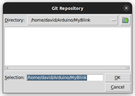

Once that is saved, launch git-gui. It opens to this dialog. Choose Create New Repository.
Click Browse and:
Hit Create.

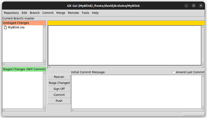

This is the screen you get in git-gui once you have your repository open.
Since there's never been a commit here, the file is up there in the Unstaged Changes area.
Click on Stage Changed and it moves to the bottom section Staged Changes. Add a comment to the window on the bottom right that describes the commit.
Then press Commit
The files seem to just disappear from the gui window. That means that the repository is completely up to date and all changes are committed. Congratulations! You now have your first Git Repository.

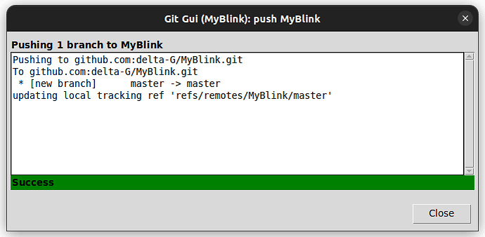

This is the dialog that comes when you select Remote -> Push
Choose which branch or branches to push. You can use Control and Shift to multi-select in the usual way. Click Push. You may need to enter a passphrase for your SSH key if you were smart and gave it one.
Finally you see this:
And if you open github and look at the repositories you will see the new repository there now has the file in it.
