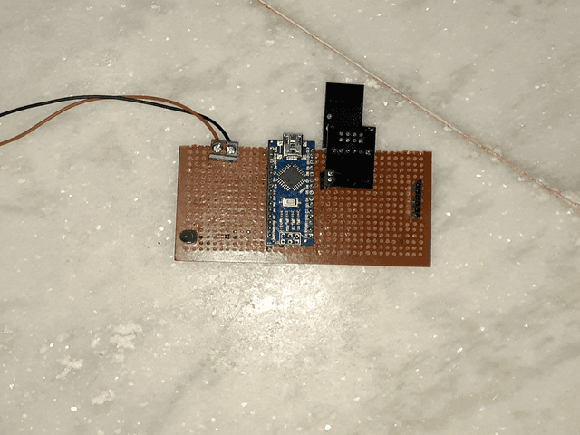

I hereby attach my circuit board's pictures for your reference :slight_smile:
Tx side front circuit board
TX back side of board
Rx front side circuit board
RX back side circuit board

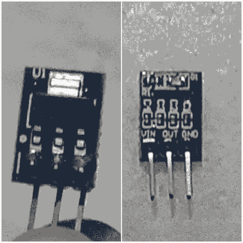

AMS1117-3.3v regulator boards for tx side for supplying nRF24L01+ from 2S Li-on batteries
at RX, i'm using below AMS1117-3.3v regulator board for powering nRF 24L01+ from Lion batteries
And i'm powering both rx and tx arduinos from computer USB to see the serial monitor feed at both sides
This is the whole setup below,

Looking at the photo in Reply #9 I reckon the high-power nRF24 is too close to the other one. Try them at a distance of 3 metres or more.
...R

oh sorry for that, I'll replace all the images with low resolution ones. And I also thinking about increasing the distance between them since I saw the same suggestion, u have given to someone in one discussion of this same problem. I'll definitely do this and i will reply if I have any improvements, Thank you : )
