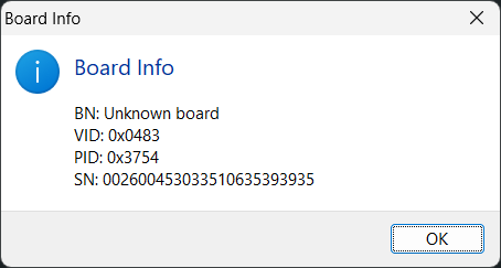

When I select the correct port, and hit board info I get:
I downloaded STM32 Cube Programmer, and upgraded the firmware.
11:40:40 : ST-LINK SN  : 002600453033510635393935
  11:40:40 : ST-LINK FW  : V3J13M4
  11:40:40 : Board       : STLINK-V3MINIE
  11:40:40 : Voltage     : 3.24V

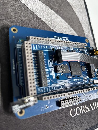

I have the jtag connected as follows:
I followed the following guide to connect the JTAG (page 11):
STLINK-V3MINIE debugger/programmer tiny probe for STM32 microcontrollers - User manual
It indicates that even though the cable is 14 pin for the STLINK v3 MINIE, for 10 pin connections, you leave 2 pins on either side hanging off the plug. PIN #3 on the ST LINK v3 MINIE is PIN #1 on the Arduino Giga JTAG. The Giga datasheet ( ABX00063-datasheet.pdf (arduino.cc)) seems to indicate that connector J8 on the board has its pin #1 indicated by the *.
Any ideas why this is not working is greatly appreciated!
