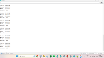

I once did a test on an Arduino Uno R3, where I alternately wrote b01010101 and b10101010 to an EEPROM location. I then read the location to check whether the data had been written/read correctly.
I got up to over 5.3 million write cycles before an error occured. I realise that this was only a sample of 1 device, and there will be considerable variations in life expectancy.
