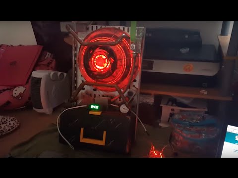

I am currently building a proton pack from the new rebooted ghostbusters movie (don't hate me lol).
I have learned a considerable amount regarding coding now and have managed to succesfully crow bar a load of code in based on different actions. The only problem is, I'm only comfortable with the delay function and I'm already quite familiar about how much of an a*se ache this can be when multitasking.
My project involves
1 x 24 Neopixel Ring
1 x Momentary switch (trigger)
2 x Rocker switches
4 x RED LED (for barrel of the gun)
1 x red LED for power blinker
1 x WHITE LED for muzzle strobe (to simulate firing)
Switches are currently different in the video I've linked, but that's the end goal.
Here is my sequence:
Arduino master switch (rocker 1) turns power on and instantly causes the Neopixel ring to do a single colour wipe in red then fade in and out continuously.
Then: Rocker Switch 2 turns the 4 barrel LED's on, Neopixel Ring begins chase sequence, power blinker... blinks.
Once the above has happened...
Momentary switch (trigger) causes NPR to strobe, 4 LED's to do a chase sequence, white muzzle LED strobes and power blinker remains solid red.
Video:
Sadly the delays in the code halt things from running continuously so I'm keen to move away from delays and try to implement milli's. I had a crack at it, but still failed on the overall project. Ideally, when the trigger is pressed, I'd rather the neopixel strobed simultaneously with the LED's on the breadboard chasing, instead of alternating... Which is exactly what you'd expect from the delay function.
I've tidied up my code as much as possible before posting it here. Any help to start phasing out delays in my work would be very much appreciated.

maybe using a FSM (Finite State Machine) approach would yield better results for you?
Might be a little daunting at first.. but after looking at an example for 5-10 minutes.. it should 'click'...
(Not sure if anyone has shared code on their projects over at the RPF.com or not?.. might be worth a search)
Also.. using Neopixels..
can 'sometimes' be a disadvantage if you want to do a lot of other things at the same time.
since Neopixels need specific timing to 'run'... you are not left with a lot of processing power (or time) to do other things.
You might need to code your 'patterns' in a different way, so that it can (incrementally) update the NPR pattern one step, and check to see if anything else needs to be done.
I think there are some alternate/advanced Neopixel tutorials on Adafruit that covers HOW to update these patterns, as well as how to check for other things (like button presses..etc) while still updating the NRP pattern.
