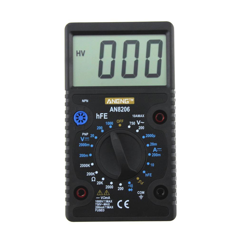

A multimeter is the thing for seeking shorts, on the 200 Ohms range. Digital multimeters test resistance using the 200 mV scale, so will not detect diodes, transistors or "parasitic" or protection diodes. To detect those, they have a "diode test" range that is 2 V instead.
Suspect you were detecting your fingers with the faint LED glow. :grinning:

If you are testing with the IC's mounted that is the reason. It might also be through your fingers if you are touching both ends and your fingers a bit damp.
Most multimeters has continuity, I have reviewed many meters and also written some articles about them (See http://lygte-info.dk ).

HKJ-lygte:
Unfortunately mine doesn't, maybe I should look into a new one.
Also I noticed another thing. In complete darkness there is a veeery weak light in the LED when connecting ground and VCC. The multimeter doesn't pick up any current on the 0.5mA scale though. Might that just be a very small leaking current from the capacitors?
Multimeters do not have a "continuity" scale - that makes no sense. It is however usual to have a piezo buzzer operative on the "diode test" scale that responds to a voltage less than the drop of a diode, thus indicating an actual low resistance connection.
Paul__B:
Sorry, maybe I should've been more precise on that. So the multimeter I got can measure DC mA, DC V, AC V and OHM x1k. No continuity testing. I still tested this with a LED, noticed a weak light when connecting ground and VCC, therefore I hooked the multimeter up to that circuit to measure how much current is leaking. I measured that on the 0.5mA scale of the multimeter and the indicator (analog multimeter) didn't move a bit. So I assume the current flowing is minimal.
I have looked at over 100 different multimeters, they all have a "scale" in continuity mode, it show ohms, but the purpose of continuity is the fast reacting buzzer, that will sound when a low resistance is measured (Usual below 30-100ohm).
In diode test the meter shows volt and sometimes uses the buzzer.
A few cheap meter combines continuity and diode test, usually with a fairly bad result.
HKJ-lygte:
More than "a few" actually! Most that do not auto-range.

I believe that is correct, with manual range the positions on the rotary switch are needed for other ranges. The value shown on the display is usually neither volt or ohm (Aneng V7 is smarter).
