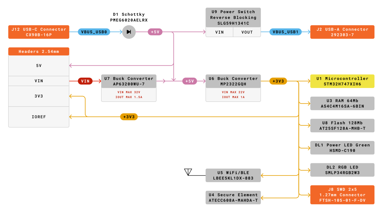

I have a project that is tried and true that runs a linear screw and has a few sensors and an endstop. The first and very important thing it does is runs towards the endstop and set ZERO.
Everything works great while powered by the usb port. I have a regulated switching power supply and no matter what voltage I set it at. 6v 9v 12v it doesnt run my sketch properly goes in the opposite direction of my endstop. I am considering setting my power supply at 5v and feeding that into the 5v rail. Anyone else experience script not running correctly while using Vin?

when powered by vin it sends my linear rail the wrong direction I have to power it down before it slams the the rail against the housing. Everything works perfectly under usb power. This is bizarre to me. I thought the only difference is there is a buck converter dropping the voltage to 3.3 and 5. Seems something else is going on.

I am telling you my sketch controls a liner screw. When it starts up it is supposed to move in the direction of the endstop and set zero. and it does this when powered from the usbC connection. When I power the Giga board with the Vin connection is doesnt operate like it is suppose to and goes in the opposite direction. I have to quickly stop it as a screw is only so long and it will crash the rail against the housing of the linear rail. I see the block diagram. I have seen it before and I dont see any logical reason as to why the power source should make any difference as to how a sketch is executed.

Hi @dysonian What version is your GIGA? You can find its version stamped on the underside of the board, next to the hole nearest the antenna.
I have 3 GIGA boards, a V1, two V1.4. None exhibit the behaviour you see with yours, however, my V1 board does have an odd quirk - it won't boot the M4 core until a write is made on the second I2C bus. The other two don't require this.
If yours is a 1st edition, it is possible that it too has a quirk. I would raise a case with Arduino support, consider buying a new board for your production model and relegating (if not RMAd) your current board to development.
p.s. one thing I would try is using a different ground pin when powering thru VIN
Steve I was beginning to wonder if anyone was going to come up with an more plausible answer than blaming it on me my code or assuming I dont know what I am doing. Indeed it is a V1! It seems a common trend on the forms here lots of assumptions. Including you. Steve I really appreciate your response and hopefully it will work properly when I swap out this V1 board with one of the other 7 boards I have 6 are still unopened but the one here I am looking at says v1.6. I have never powered it up. I will swap it and flash it with my sketch and see if there is any difference. Thanks you
I swapped to a v1.6. Malfunctions the same. Still works perfectly powered off of the usb-c. Tried different grounds. Added delays all over the place same... I tried a pull up resistor on the direction pin to force it and I get the same result yet the usb-c always functions properly.
