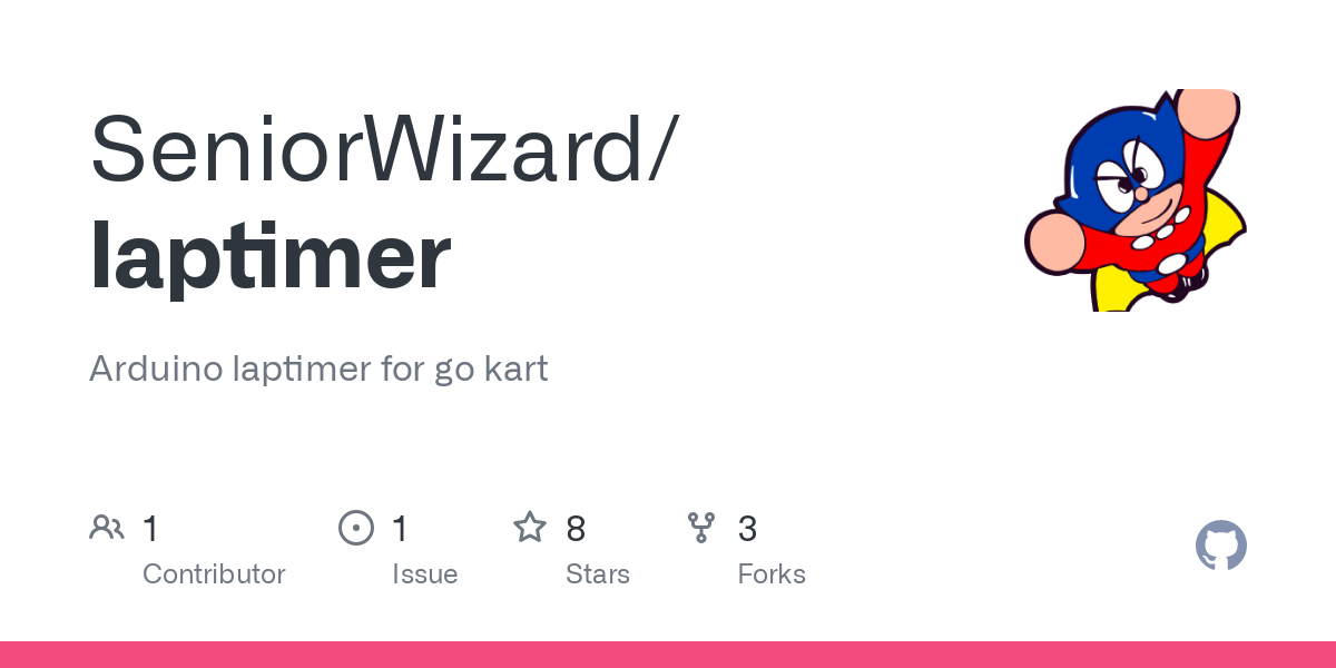

I haven't finished reading it all yet, but I dug this up 10 minutes ago: Kart Racing Lap Timer With LCD/LED Screen, Speed, Temp, Magnetic Pick Up - Project Guidance - Arduino Forum
It's pretty much exactly what I am trying to achieve!
