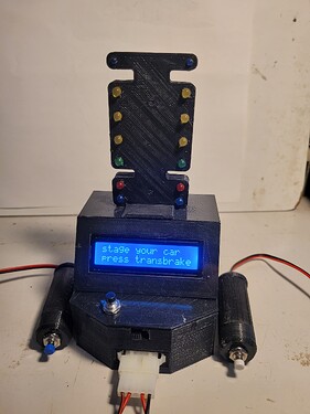

I make cases with my cheap 3D printer (<$200.00US).
This is the case for a drag racing game that I made. I use all free tools to do the 3D design and printing. FreeCad for 3D modeling, Cura slicer, Marlin 3D printer firmware.
