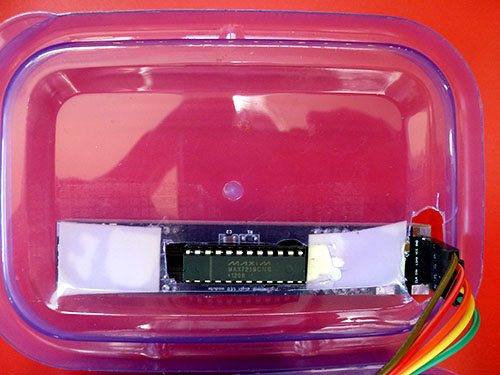

Then I grabbed the MAX7219 8-digit LED module that recently arrived from eBay for $10.
Connected together and assembled into a lunch box it looks like this:
The photo doesn't do the digits justice, they look higher contrast in a normal room:
The LED module is stuck to the LID:
The overall effect:
