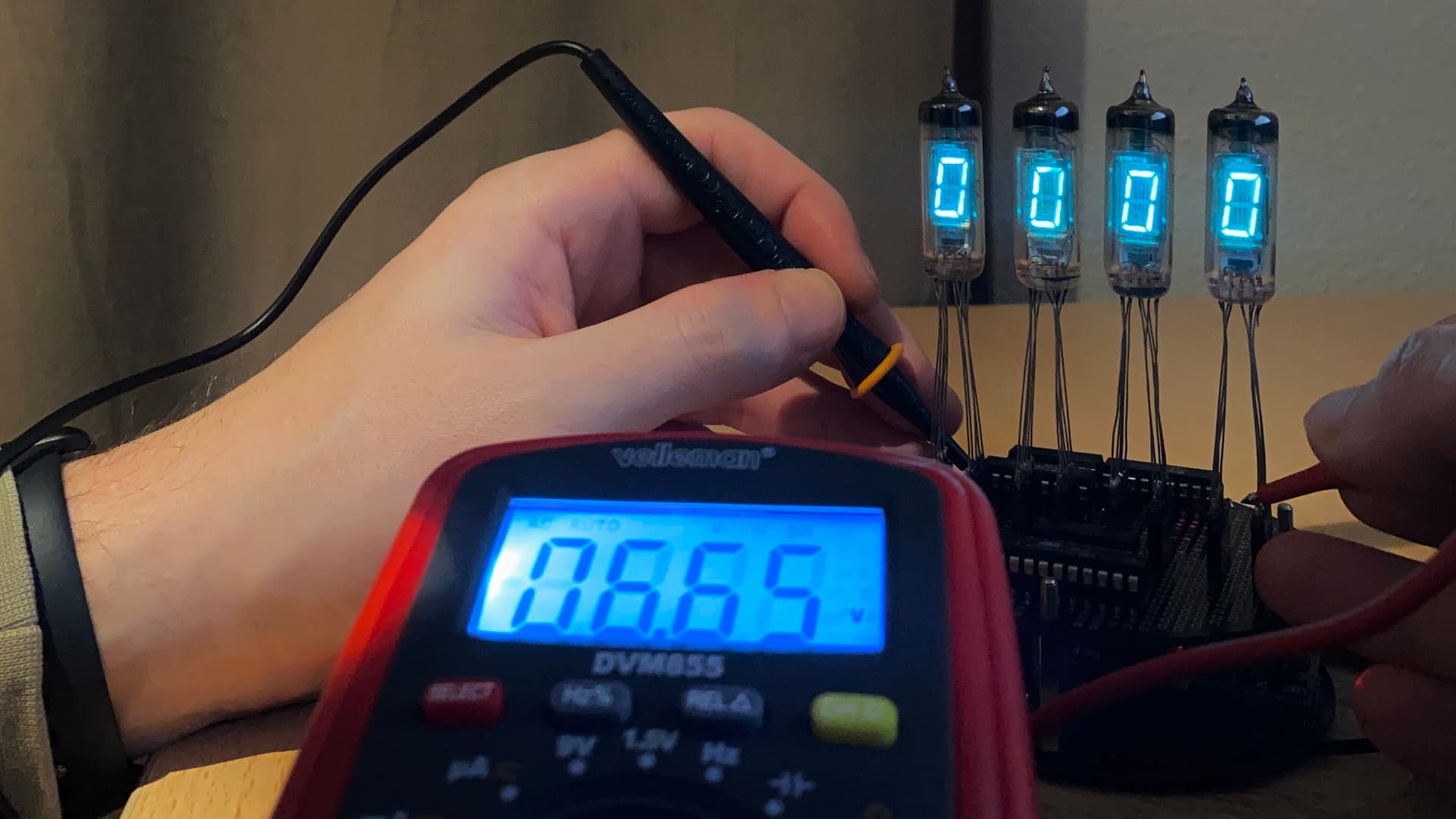

I ran into something equally interesting: I noticed the segments are slightly more dim than when individually powered with 27v. Not so strange as we are multiplexing all four of them. I now plan to increase to voltage for a brighter effect. As a reference for the calculation it would be safe to measure the grid pins.
Would it be correct to say that each grid pin has a high time of 5ms in a 20ms period? When I measure the grid pins it reads a duty cycle of 25%, 50Hz and almost 7v.
That sounds legitimate according to the formula:
Duty Cycle = Pulse Width (sec) x Repetition Frequency (Hz) x 100
( (0.005sec x 50Hz) x 100) = 25
Also the 6.6volts on the grid sounds agreeable too, as 27v / 4 is in that range.
So if we have a duty cycle of 25%, an input voltage of 27v and an output of 6.6v it means my input has to by 4x greater. This means around 108v input. That doesn’t sound right to me...
According to a 'translation' of one of the IV-6 datasheet the anodes should be able to handle up to 70v 'in pulse'. The source driver on the other hand can only handle up to 50volts, but would it be safe to crank the supply voltage up to 50v?
I may have gotten way too mathematical with this, but I'm confused now and very eager to exchange some thoughts about this.

Clearly for your power calculations, there are some maximums to be observed. For example, I guess that in "pulse mode" a pulse has a maximum period (width) defined somewhere.
Be careful about calculations based on a digital voltmeter against PWM. The volt meter will integrate the results to give an average. However, the device under test may still be stressed by the over voltage. Example: 1000 volts with a 1% duty cycle may read as 10 volts. A 1% duty cycle could be 1 second on and 99 seconds off, or even longer, say in some heating applications.

Lastly I have a VFD clock update: I changed the 5ms interval to 2.5ms in order to see what this would mean for the brightness of the tubes. I am now measuring a slightly higher voltage (+/-16v) at the segment pins and as a bonus I dont see the 'flicker' of the GPS updating anymore. Happy days.
