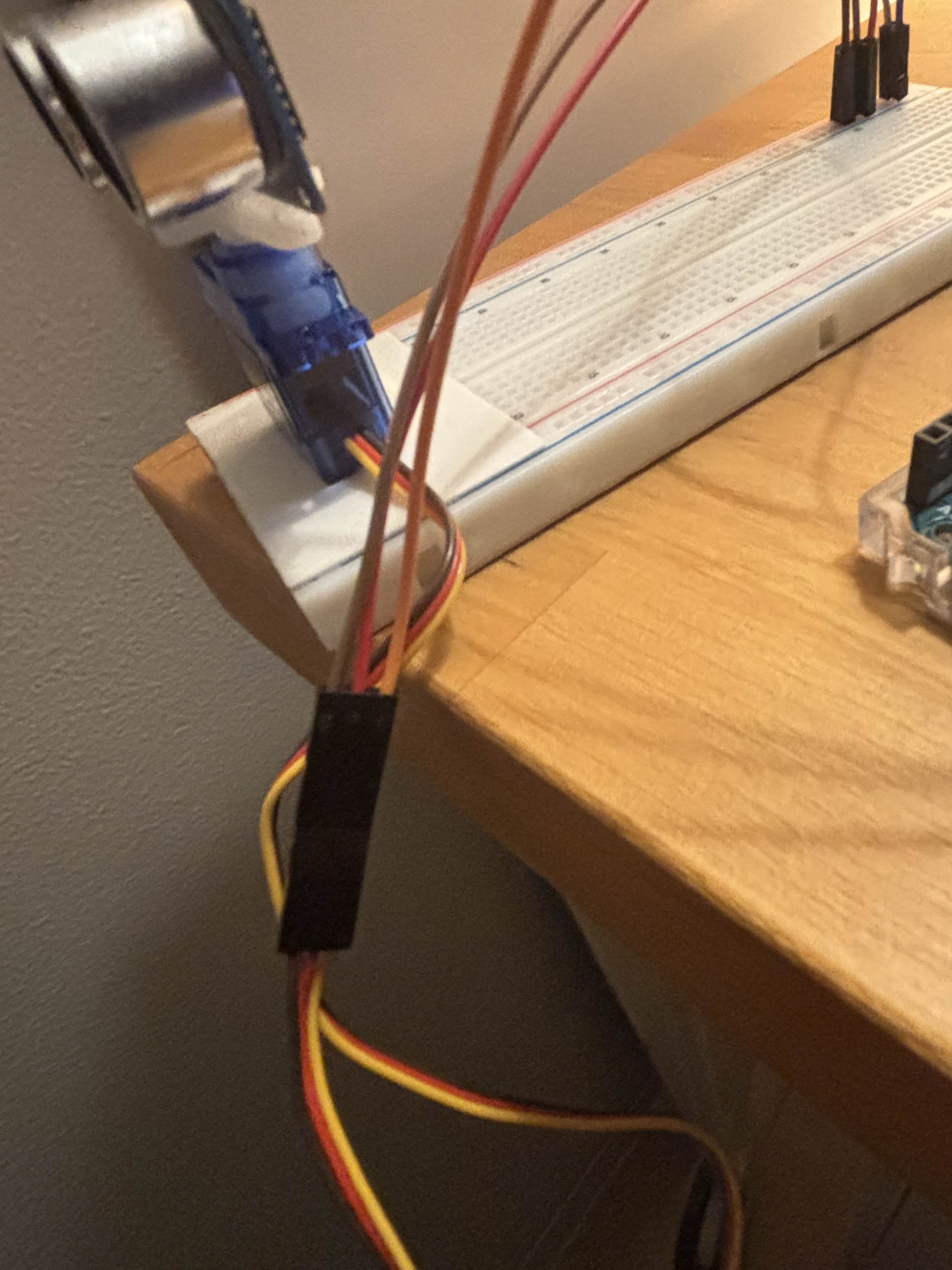

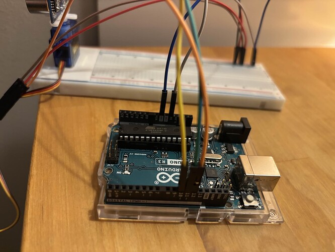

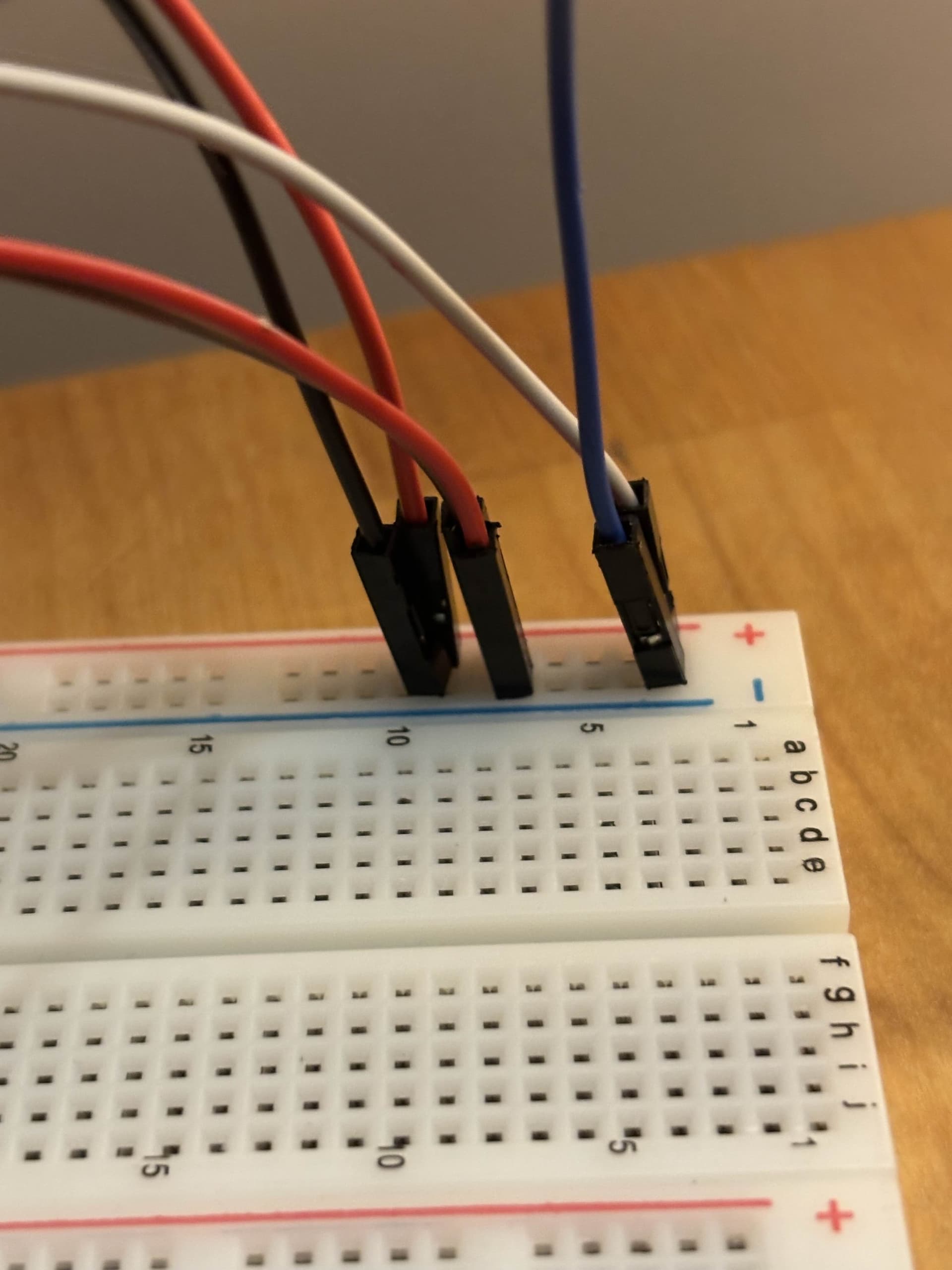

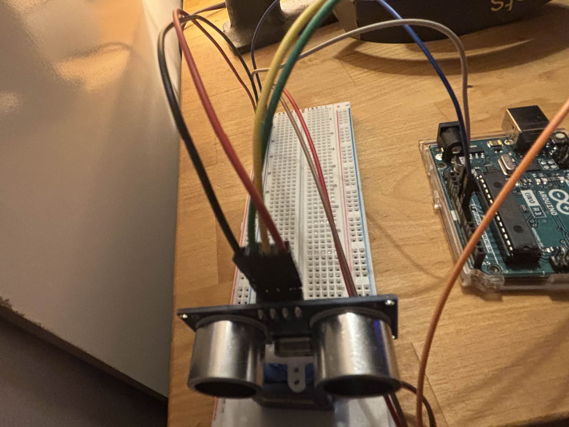

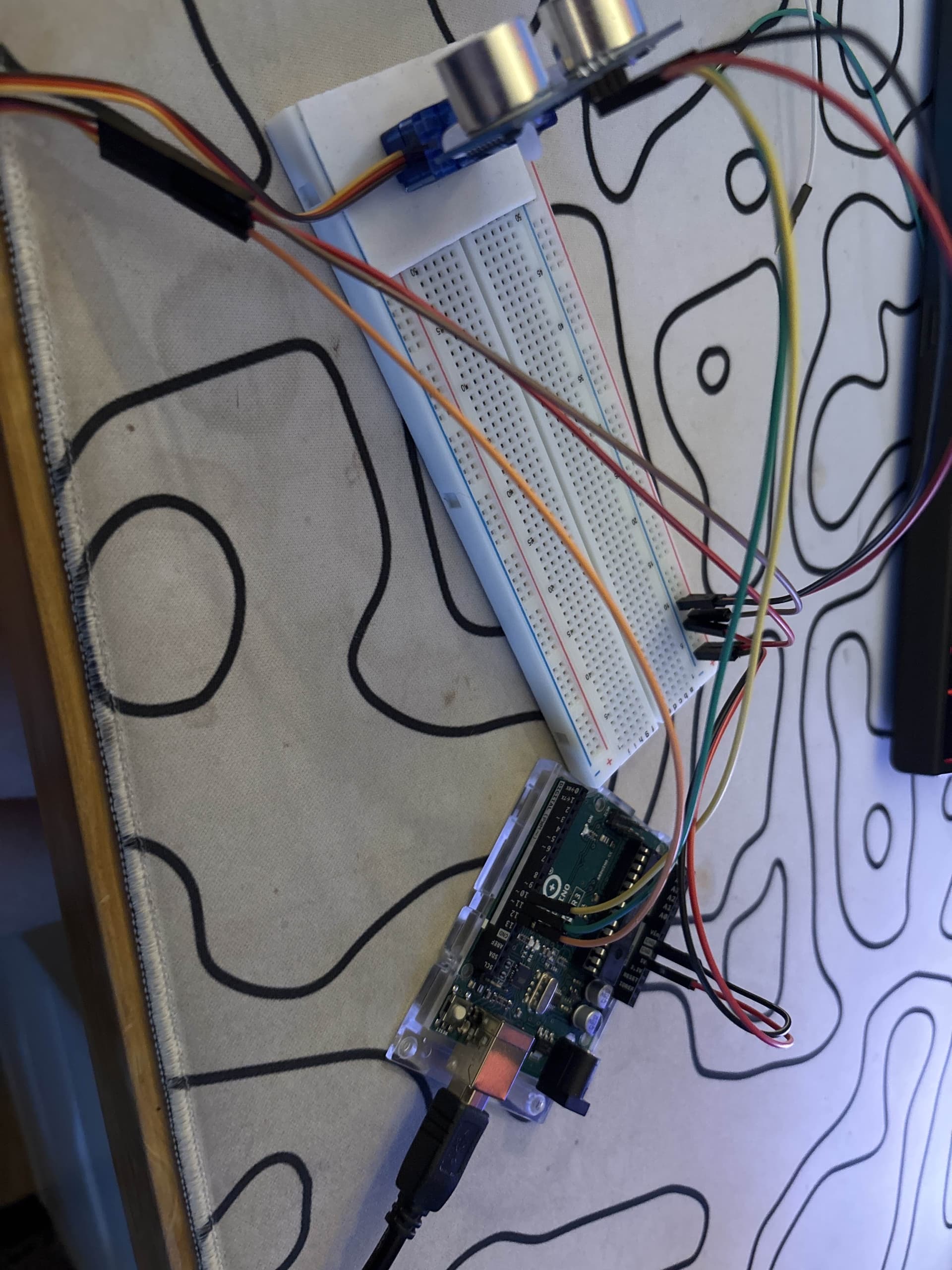

Today i got my first arduino ( uno R3 ) anyways i was following this tutorial to make a sonar radar heres the video https://www.youtube.com/watch?v=lbFKDNOYW3w . But when I plug in the ground and 5 volts together it just turns off the whole board

please post a better picture.
and a schematic as well as your code.
without all that, we cannot help…

usually brown is - and red is +…
it seems your servo is powered the wrong way…
simply remove the power wires and see if the controller works. if so, I might be right… then swap the wires…

Draw by hand the wiring diagram. Now take a photo. These pics do not help.
Are you sure that the marked connections ain't the wrong way around?
Does the board still work on it's own, powered through the USB connector?
If it does, you're lucky. Don't reconnect other stuff until you check all the breadboard connections.
Agree with sterretje.
My colour vision is poor, but it sure looks like a red on the negative rail.
@char0 While electricity doesn’t care about the colour of wire, in order to make sure you haven’t made a mistake it is vital that you always use Red wire for positive voltages, and Black wire for negative voltages, because otherwise it causes alarm bells to ring in the heads of people trying to understand your wiring.
When you get a bit more experienced you can use Red like wires for positive, which to me are Orange, and Black like (or rather ground like) colours for negative. This is a wider range because I will use Green or Blue. But for now stick to Red and Black.
