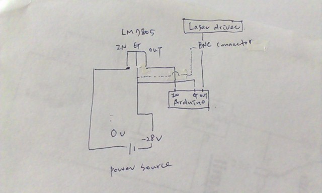

sorry that I didn't explain it clearly. Attached are the two circuits that I plan on using (sorry that I don't have software for this kind of drawing). Just not sure which grounding scheme is more appropriate. The first scheme treats the input to uno (reducing source power volt) and the output from uno as two circuits; the second one lumps them together. I worry that the 2nd one might accidentally feed undesired currently back to the power source (which will potentially blow the power source) if the relative voltage of uno ground is different from the ground of 7805. But I am not sure if scheme 1 is grounded sufficiently. Or maybe the basic design has some fundamental flaw?? Any suggestion will be greatly appreciated.

Well that is also confusing for different reasons. The polarity of you external power supply as wired to the 7805 appears to be ok, however you don't have the common side of the power supply (what you call -28) wired to a arduino ground pin, and that is required.
But also I don't understand why you have a jumper wire connecting what you call output (an output pin?) connected to a arduino ground pin? If that is the case if you ever set the output pin to a high (+5vdc) it would be a direct short to the arduino ground pin, which would destroy the output pin. So the wire you labeled with a ? is correct in the second drawing, but again both drawings show a jumper wire from arduino ground to something labled output, which is most certainly incorrect as stated before.

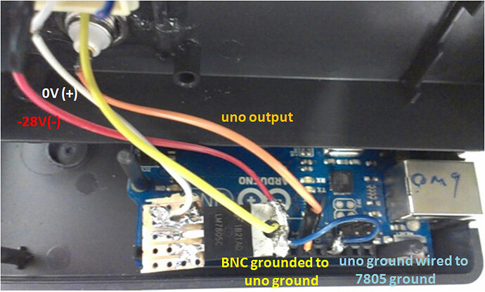

So the jump wire from uno output is actually to ground the metal part of female BNC connector (in the attached photo 2 yellow cable). Sorry maybe my drawing in that part isn't correct.
This is how I wire power source (white as 0v, red as -28V) to 7805, 7805 ouput pin to uno input pin, uno output pin to BNC (orange) and the ground from uno (blue).
So do you think grounding BNC in this setting will be an issue??

Well I'm reluctant to say it but your wiring maybe OK as best I can tell. ![]()
However you seem to lack input and output filtering capacitors for the 7805 voltage regulator. Check a datasheet for that regulator and you should be able to find the info for recommended cap sizes and try and locate them close to the regulator.

Is it likely that somehow the ground is sending some unwanted noise (from the output BNC connector due to the triggering of downstream device, please see photos in reply #5) back to the power power supply and that interferes with the circuit of power supply??

In the diagram (apologize that if it's not clear to you),the 0V wire is connected to the input of 7805, and -28V wire to the 7805 ground (and thanks for restating the need of capacitors). Output of 7805 to uno input pin, uno output pin to a BNC connector that will be hooked up to the downstream device. The uno ground is wired to 7805 ground. The metal part of BNC is also grounded to the same ground. Don't know if the attached diagram will be better (and apologize in advance if it's not).

Thanks for pointing out this issue, I had a little concern initially about this grounding scheme, but since the arduino seems worked fine in the absence of downstream laser driver I didn't think too much about it.
I did another test today by removing the BNC from the ground and it didn't help either.

In that case I would go with the opto isolator suggestion in reply #16. There is no need to have a 7805 voltage regulator and it takes the -28V grounding out of the question.
First test that your Laser and arduino work together without the input voltage. If that works then use the -28V to drive the LED side of the opto through a sutiable resistor. Have the transistor side connected between the arduino input pin and ground and enable the internal pull up resistors.
