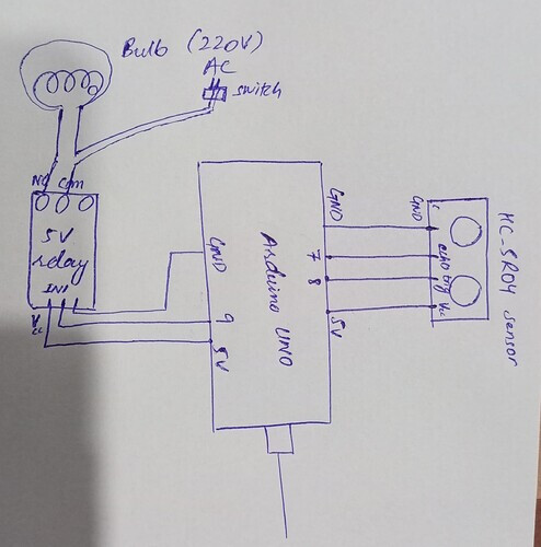

In my quality lab, there's a small water tub (length 8 cm) fixed on hydrolysis oven (for fabric testing). the water should always be present in tub at a certain level (4 cm from bottom). I need to install ultrasonic sensor within tub so that whenever water will be below 4cm, a 220V AC bulb will be turned on. And upon refilling the water, sensor will detect the water level and will turn off the bulb.
For this, I have used 5V relay, arduino UNO and ultrasonic sensor HC-SR04. Let me know, If any additional component is required.
How I'll use new ping library of HC-SR04 in programming to get better and long lasting results.

I would suggest you use a waterproof ultrasonic sensor like the JSN-SR04T Ultrasonic Sensor as the HC-SR04 is not waterproof and might get damaged.
The image below is an image of the Waterproof JSN-SR04T Ultrasonic Sensor
I’d be looking at your power supply.
Driving any significant load from an Arduino is not a great idea.
If this is really what you’re doing, replace the relay with an SSR, and either way, be careful of your mains wiring.
Thanks for your suggestion, Yes, It's waterproof but It's minimum range is 20-25cm, whereas my requirement is 4cm. I've already tested it.
Relay that I'm using has maximum current range upto 10A. Means It can bear arduino (20-40mA) can operate on it?
for detecting water levels in small containers I have used TOF sensors and capacitive sensors, e.g. Grove - Water Level Sensor
also used a JSN-SR04T waterproof ultrasonic sensor for checking river levels, however it's range is specified as 25-450 cm so may not be suitable for your application
10A is the current through the relay contacts on the load side. You need to look at what the relay coil needs. A 5V wall wart is a much smarter choice to power the relay. OR even better switch to a MOSFET to replace the relay.

Can I use BC547 Transistor for Arduino to safely control the relay, instead of MOSFET.
Yes, I've implemented hysteresis in my code with a 0.5cm buffer. The light activates when water drops below 3.5cm and turns off when it rises above 4.0cm. This prevents rapid switching from small water movements or sensor fluctuations. Is there anything else I should consider in my implementation?
