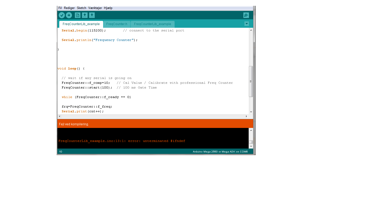

the code is
// Frequency Counter Lib example
  Martin Nawrath KHM LAB3
  Kunsthochschule f¸r Medien Kˆln
  Academy of Media Arts
  http://www.khm.de
  http://interface.khm.de/index.php/labor/experimente/
#include <FreqCounter.h>
unsigned long frq;
int cnt;
int pinLed=13;
  pinMode(pinLed, OUTPUT);
  Serial.begin(115200);        // connect to the serial port
  Serial.println("Frequency Counter");
  // wait if any serial is going on
  FreqCounter::f_comp=10;   // Cal Value / Calibrate with professional Freq Counter
  FreqCounter::start(100);  // 100 ms Gate Time
  while (FreqCounter::f_ready == 0)
  frq=FreqCounter::f_freq;
  Serial.print(cnt++);
  Serial.print("  Freq: ");
  Serial.println(frq);
  delay(20);
  digitalWrite(pinLed,!digitalRead(pinLed));  // blink Led
header file
  FreqCounter.h - Library for a Frequency Counter c.
  Created by Martin Nawrath, KHM Lab3, Dec. 2008
  Released into the public domain.
#ifndef FreqCounter_h
#define FreqCounter_h
#include <avr/interrupt.h>
#if defined(ARDUINO) && ARDUINO >= 100
#include "Arduino.h"
#else
#include "WProgram.h"
#endif
namespace FreqCounter {
	extern unsigned long f_freq;
	extern volatile unsigned char f_ready;
	extern volatile unsigned char f_mlt;
	extern volatile unsigned int f_tics;
	extern volatile unsigned int f_period;
	extern volatile unsigned int f_comp;
	void start(int ms);
#endif
There is a difference between
and
#include "FreqCounter.h"
The difference is where the compiler looks for include files. If one doesn’t work, because you have not installed the library as a library, try the other one.
Thanks PoulS
now I changed header file from #include <FreqCounter.h> to
#include “FreqCounter.h”
I can see that was a part of the compile error, but still the compile problem not disappear,
new one is her: on the piture
how to install the library as library ?, sorry my novice questions?
thanks again
