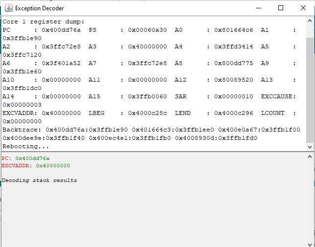

I installed the ESP Exception Decoder and put the error there, but apparently it's not a code-specific or library-specific error:
I get this error sometimes when I get a mqtt message a little big (21000 bytes). Even though the mqtt buffer is 30000 bytes in the code. It's not an error that happens all the time, so I think it's RAM overflow, is that possible?

In some of those moments, when receiving the mqtt, he gives this Guru Meditation error. Not always, in some random moments.
Guru Meditation Error: Core 1 panic'ed (LoadStoreError). Exception was unhandled.

Backtrace: 0x400dd76a:0x3ffb1e90 0x401664c3:0x3ffb1ee0 0x400e0a67:0x3ffb1f00 0x400dee9e:0x3ffb1f40 0x400ec4e1:0x3ffb1fb0 0x4008930d:0x3ffb1fd0
Rebooting...
Putting the error in the decoder, nothing else is displayed:
It's incomplete. Any reason you can't post the full code?
