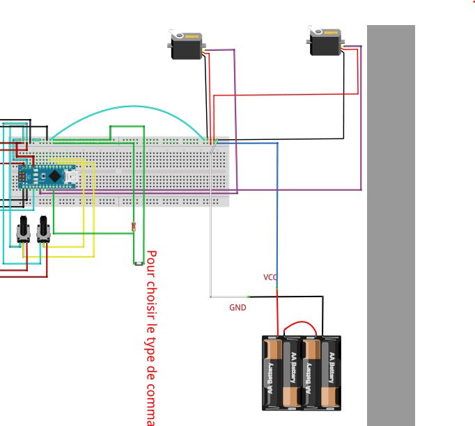

Hey, i have a Servomotor from TowerPro MG958 DIGI, and it won't work ,i tried many power supplies,12 volts-0.5amps/ 5 volts-2 amps, and i tried with 5v-4amps, The ground from power supply is attached with the ground of my arduino card, "it's not my first time using servo's", my code is like this :

Operating voltage for that servo is 4.8-6.6V. You may have damaged or destroyed it using a 12V supply.
Either of the 5V supplies should have worked, had you tried them first.

Since you are having problems, and since it works for small servos but fails for the high power servo, I simply must ask for a wiring diagram showing how you have the servo powered.
Pen, paper and a camera will do just fine.
A very large percentage of all servo problems on this forum are due to improper power for the servo.

The other possibility (as VinceHerman intimated) is that you're trying to power the servo through the Nano.
That can work for unloaded servos with a low power requirement, but not when the stall current is 1160mA.
here you go the images , the wiring diagrams
The 5V 4A supply is the only one remotely likely to power this high torque servo, 6A might be better.
Its rated at 2Nm and 5.8 rad/s, so the mechanical output power is 12W or so, its a beast.
Also, given the high stall current (1600mA I think) your breadboard may not be able to manage.

thanks for your response, so what do you suggest to make it work !?, how i power it !
See reply #11. Solder or use sturdy connectors for the power leads -- do NOT use a breadboard. Don't forget to connect the grounds.
