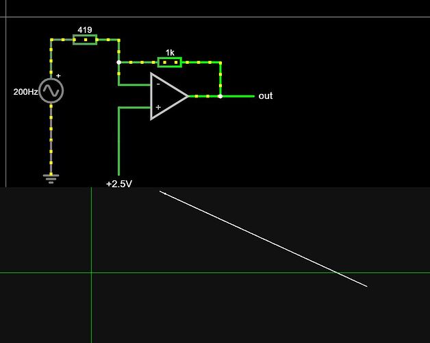

All right, antispam downed my post for a while, i stumbled upon this blog post , which explained op-amp usage in similar situation
I fired up Falstad's circuit simulator and it is almost what i need - except output voltage could potentionally go below zero or above 5V - is there a way to clamp signal? Maybe mighty op-amps could do that too?

Anyway, i'll try op-amps on breadboard and get back to this topic again
