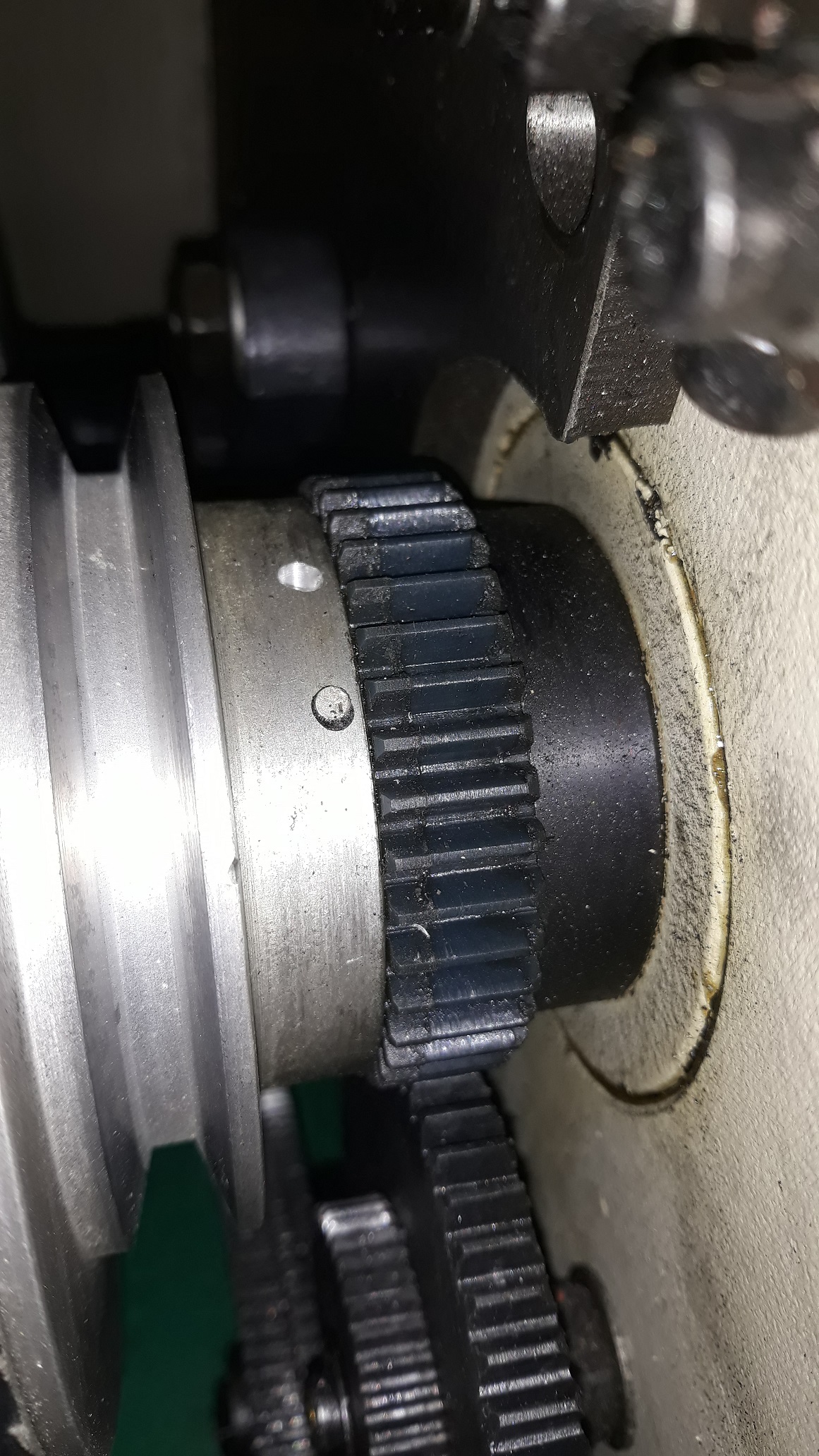

Hi All,
I've put together a tachometer display to show the spindle speed on my lathe. It works well when bench testing but as soon as I go near the lathe with it the readout goes crazy.
I'm using and OLED for the display, an AH1807 Hall sensor and an Arduino Uno (RedBoard).
This is the data sheet for the hall sensor and it is wired according to the diagram on the second page.
I've tried 2 different hall circuit configurations.
First was to have the 10K resistor and 70nf capacitor down on the BOB with the arduino and the hall sensor by itself and the end of the wires.
When the lathe was started the displayed RPM would jump around within the 10s to 100s of thousands regardless of how fast/slow the lathe was running. If I was to move the hall sensor about 100mm away from the machine it would settle down and finally rest at 0 rpm.
Second attempt was to move the 68K resistor and 70nf capacitor up with the hall sensor.
In this configuration I found the arduino itself was susceptible to noise as well as the hall. But the end result was no different than the first. I had to remove both from within the lathe before it would settle down.
Is the a better way to wire a circuit to prevent this, or some way to shield everything from interference?

Use shielded or twisted pair cable to reduce external noise. Connect Arduino GND to machine GND.
Eventually the sensor is too sensitive for your application. Mount it onto a U shaped iron/ferrite core to limit the sensitive area to the open end of the U. Modify the mounting to match the sensitivity direction of the sensor, the data sheet contains almost no hints.
Have you tried using a drill as your source of rotation to check if it is code or interference from the lathe motor?
Have you got some simple code that just puts the RPM on serial monitor and does not have any of the display code in it?
Thanks... Tom.... :slight_smile:

It's a small metal lathe and those speeds are from a test rig. If I take it near the lathe it goes haywire.
OPs image,
How many magnets do you have on the shaft, and are they all oriented the same way?
Tom... :slight_smile:
Just the one magnet. And I don't think it matters which way it is with the AH1807 Hall. The magnet is a little ND 3mm diameter x 4mm length. Not sure on the gauss but it should provide ample field for the hall.
gyrojeremy:
Do yu have a much weaker magnet to test with? That one may be spreading it's field so far that there are twists and wriggles in the field.
Is the magnet mounted on steel or other magnetic material? If so, it may be creating other magnetic fields.
Paul
A magnet on/in steel, the steel will try and soak up the field.
Hall sensors have an axis they measure field along, it should align with N-S to get the highest reading.

I forgot to mention the magnet is mounted in an aluminium pulley. The pulley is mounted on a steel shaft. At a guess I would say there is 5-10mm of alloy between the magnet and shaft. The gear next to the pulley is plastic.
