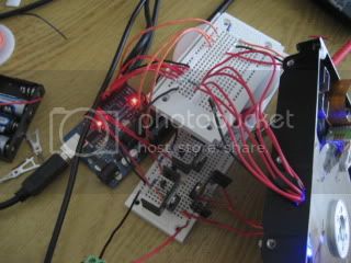

this is my second arduino project. another persistence of vision. i feel like it's much better than my other project, so i am quite excited.
However, it's still a work in progress and tons of little things to fix/ reprogram. i just feel like showing off a little bit first ;D

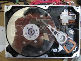

this is a hard drive clock. I've saw some cool ones out there, so i wanted to make one myself. However, the ones i saw was either numeric time display (with numbers cut out on a plate) or hand/dials (with a silt cut on the plate) Instead of choosing just one, i wanted to make one that's capable of displaying time/ message in any way i want to.
What i have done:

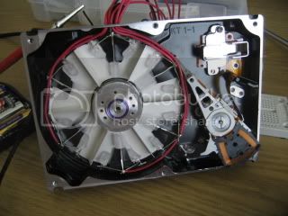

-- i have drilled 6 holes through the plate, each on a radius 60 degree apart. each a different distance from the center. or in other words, i have 6 points in polar coordinate [1,0o], [2,60o], [3,120o], [4,180o], [5,240o], [6,300o]
-- underneath the plate, i have divided it into 6 compartments of LEDs, each individually controlled.
-- there's a small magnet on the plate and a hallf effect sensor indexing the plate's rotation (you can even see them in the picture if you look hard enough)
-- with a little programming on our beloved arduino, we can have right compartment blinking at the right time to display 216 different "pixels"
problems i had:
-- never worked with a stepper motor before, i had a hard time getting the hard drive spinning at first. i had stripped down hard drive to four wires in the back, so it took me a lot time to figure out which 3 to pulse (and which one was the common cathode.)
-- after much frustration and fruitless tries, i realized 5 volt with 40ma per pin was the problem. (who knew motors need so much power? :))
so i added some 2N2222 transistor to amplify the current.
-- after i FINALLY got the motor running (it was also really tricky finding the right increment to accelerate it from rest) my resistors / 2N2222 started smoking. :o i looked at the datasheets again. i guess they weren't rated for 5v & 800ma (4 watts). opps. i bought some extra high power transistors to solve the problem. so it's 4ma from arduino amplify to 50ma from 2N2222 to ~1.2A from a power transistor. appearntly the setup is called a darlington pair
-- everything is running great. then suddenly everything stops. i keep thinking things are overheated, but apparently AAs batteries run out of charge rather fast. lol i now haev it pluged into an ac adapter
here's some more pictures, i shall post up the code or more pictures after i tidy things up and fix those leaking light dots.
next step: fixes those darn leaking light, or perhaps make it RGB?

sounds good! The misalignment with the numbers, is that due to inconsistent drilling or is it just uncalibrated?
I'd really love to see more pictures and code, possibly video?
the misalignment is due to the compartment (where the light are separated into compartments) isn't perfect made. so light leaks between and create unwanted light spots
