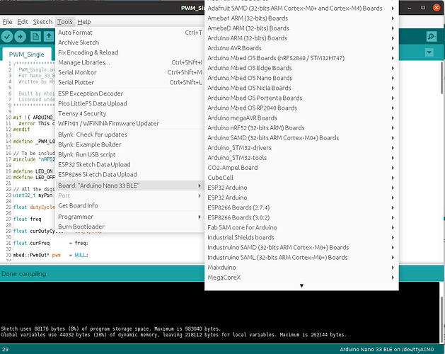

Hello @khoih-prog
Thank you for developing this. It has come with perfect timing. I really could use it for my automotive PWM fan control which runs at 10 Hz.
I am tying your PMW_Single code and not getting it to compile, see error message below. I also found that I needed to rename the include file to "nRF52_MBED_Slow_PWM" because that is the file names and directories as installed. Ultimately I need to get the attached file to work with the Nano 33 BLE. It currently works with an UNO.
I would certainly appreciate whatever you can do.

First, you have to select Tools->Arduino Mbed OS Nano Boards->Board: "Arduino Nano 33 BLE" to compile, using the ArduinoCore-mbed core v2.8.0+
Then you have to convert your program, written for AVR boards (UNO/Nano/Mega, etc.) by yourself or ask for help in separate thread.
Anyway, this the the revised code, written for Nano_33_BLE board. Please modify as necessary, test and report the results here as I don't have the same board or settings to test.
Still messy, just little bit better

Thank you very much for your time. Did did not expect you to go and rewrite the code yourself. What I found is that when I installed the library, I had inadvertently selected the wrong library. I had installed:
nRF52_MBED_Slow_PWM.h
instead of
nRF52_MBED_PWM.h
So once I got the correct library installed the PWM_Single program worked. However changing the frequency to 10Hz did not work. The serial monitor reported 10Hz but the light was blinking at ~ 30Hz. I even tried setting it to 1Hz and it still blinked at about 30Hz. I do know that 31Hz is the lower limit for PWM without hardware libraries and it appears that the output is defaulting to that minimum.
As far as the updated code you sent me, I am not getting any PWM signal out of it at all. Please understand I am an old Fortran programmer so that code is very difficult for me to understand. If I can get the PWM_Single program to work at 10Hz I believe I can modify my program to get it to run. Attached is the serial output from PWM_Single reporting a frequency of 1Hz but the light was still blinking at about 30Hz.
