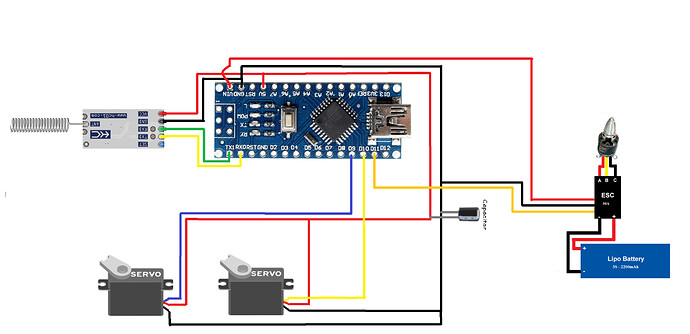

Hello,
I'm new to this and I'm trying to do an RC airplane transmitter and receiver. The problem that I encounter is that both servos and the brushless motor jitter/chatter/vibrate.
In the transmitter, I use an Arduino UNO + HC12 + 1 joystick that controls the 2 servos + 1 potentiometer that controls the brushless motor + 1 switch to stop/start transmitting.
In the receiver, I use an Arduino Nano + HC12 + 2 Servos + 1 Brushless motor.
I was reading a lot about it and it could be caused by:
  • Servo.h and SoftwareSerial.h library timers: I have changed the library Sevo.h for ServoTimer2.h
  • Instability of the joystick, the values change too quick: I have included a code that the servo will only be moved if the new value change more than 20
  • The voltage drops when the servos start: I have added a capacitor in the receiver
However, it is still vibrating and I have run out of ideas. Does anyone know how I can solve this problem?
This is the transmitter code and I also attach the sketch so you can see how I have connected everything:

An important consideration when servos and ESCs/motors are jittering is often how they are powered. You seem to be powering the Arduino via the ESC's BEC to Vin then servos from the 5V pin, so through the internal linear regulator, usually a bad idea. What ESC are you using and what is its BEC output voltage? They are normally 5V which is too low for Vin.
Also using SoftwareSerial on the hardware serial pins 0 and 1 is really not a good idea particularly when you're trying to use the same pins for serial monitor via Serial.begin(), which suggests that you have the USB connection so you are maybe dual-powering the Nano.
Steve
The controller in the receiver is in no way going to keep 5V output for two servos, the internal 5V regulator is not able to supply the current needed by them, up to 2A.
Test your setup by powering the servos from their own separate 5V supply, but make sure the gnd of the separate supply and the controller are connected.

The ESC I use is BEC 2A@5V connected to a LiPo 3S battery.
@Tom If I connect the ESC to the servos and the Arduino Nano, shouldn't the ESC be able to keep the 5V? I would like to use only 1 battery in order to make the airplane lighter.
About the serial pins 0 and 1. I connected like this just to check if the jittering was due to some bad connection of the HC12. Taking inot account the advice from @slipstick, I will put it back to pins 2 and 3.
I wanted to clarify that even if I connect only 1 servo, it jitters. I checked that if I program the Arduino Nano to change the position of the servo periodically, it doesn't jitter but as soon as I transmitt the data through the HC12, it starts jittering.

Before all the more complicated fixes the first thing to try is powering it correctly. The 5V from the ESC/BEC must connect to the servos and the Arduino 5V pin NOT to Vin. You might find that makes all the difference.
BTW unless they are very small servos a 2A BEC may not be enough.
Steve
Hi Steve,
I have just connected to Arduino 5V and it's still jittering, even with just 1 servo.
How many Amperes would you suggest for an ESC? The two servos are EMAX ES08AII
Thanks!

That is a small servo so I would be surprised if it draws more than 1 amp. I had been concerned that you were using a huge servo.
You could measure the current with a suitable multimeter. Get your Arduino to move the servo arm to some position and then gently push against the arm with your finger and see how the current varies.

I'm very sorry for not answering until now. For several reasons I had to leave this project. Now I'm returning back to it and I would like to let you know all the tests I've been doing:
  1. Powering the servos separetly.
  2. Use capacitors to smooth the signal.
  3. Delete the delays form the code and create a function with millis() in order to send the data every 150 milliseconds.
  4. Use ferrite leads to reduce the noise.
  5. Use char instead of string in the code.
After all this changes, there is still some twitching but I realized that:
  1. The twitching only happens when I transmit data so I decided to only send data when there is a considerable change in the input value of the joysticks. This reduces the twitching considerably but it still exists when I want to change the position of the servos or engine.
  2. Then I observed that the twitching happens when the servos don't change the position but they receive a signal. So I modified the code to only sent the data of one servo while having the other still attached and I measured the voltage, I could see that it decreases around 0.2V and it recovers. This does not happen if I transmit the data directly without HC12.
Any idea why does this happen? I'm totally lost....
Hi again,
I have just discovered that if I use the library PWMServo.h, this twitching doesn't happen!!!
The problem is that with this library I can only use pin 9 and 10 and I need more. Any suggestions?
Thanks!
Finally!!!! Jittering/Twitching solved after using NeoSWSerial.h instead of SoftwareSerial.h!! Yahoooooo!!

Then it was definitely some kind of interrupt issue: SoftwareSerial is known to disable interrupts while receiving or even transmitting, and the servo signal is produced using interrupts...
