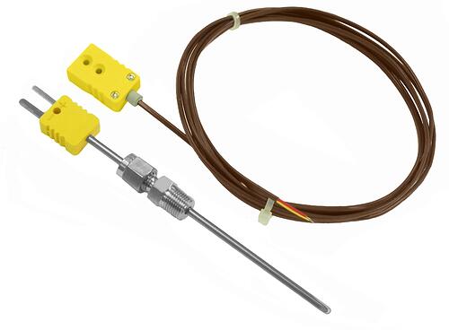

thermocouple attached with capton tape? silicon stick on thermocouple? maybe max6675 K-type thermocouple amplifyer?
i personally used fully sealed liquid thermocouples

Thanks for the reply. That looks way too big for what I am aiming. The sensor should be less than 0.5cm and just sit flat on the side of the container, that's why I mentioned flat film sensors, but as the other comment mentioned and kind of confirmed my worry is that integration with arduino might be problematic.

Thermocouple is not the right way to go if you have a range 0-100°C: Thermocouples are more used to go range 0-1000°C or 0-500°C.
You can use a PT100 + transducer to crate an analog value but then you have to calibrate, can be done, but a lot of work and fuss.
DS18B20 sensors are definitely the better choice, they can be linked using digital IO and is far more accurate compared to thermocouple and about 0.5°C. They come in all kinds of hardware sizes, some have screw connections, use google and you will find.
