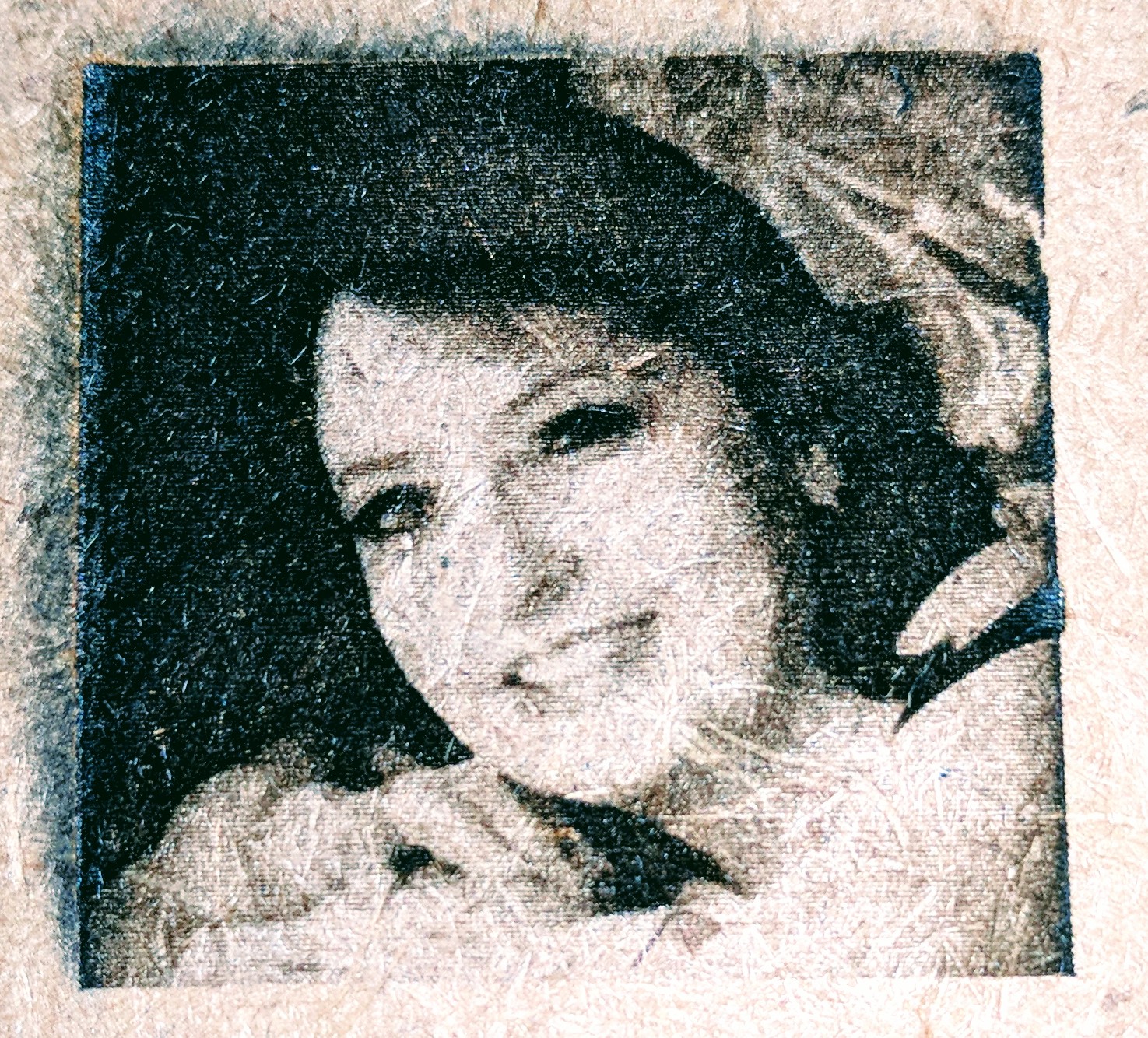

Moving this week (Chicago area) but never stopped tinkering with things Arduino. Latest creation is a laser engraver made with salvaged rails, two EasySteppers, a Nano running GRBL, and a cheap Chinese 2.5w blue-ray laser off the net.. works fantastically!

Hi focalist,
What is 2.5V strong enough to engrave? I have no sense of what power is needed for what material.
Little typo there. What can 2.5W engrave or cut or burn thru or whatever?
Wood (my purpose) can be engraved and thin wood cut, leather, plastics, likewise can be engraved and cut. Surface engraving on glass also works to some extent. Metals are not markable or cuttable generally in this kind of low-watt device. I've seen laser modules in the 10w range, but IMO anything above a couple watts and you are better off with a CO2 laser rather than diode.
However, since the 2.5w was under $70 and even came with safety glasses, hard to beat.
My purpose is to laser engrave photos onto wood, using LaserGRBL with TTL allows for pwm-modulated grayscale burning of raster images... it's a bit tricky getting contrasts right, but it's coming along nicely.
By the way, the trick for glass engraving is to use black marker or other black ink on the glass. It gives a different effect if you engrave THROUGH the glass rather than ON the glass. On the glass gives you sharper lines but through the glass produces a pleasant rainbow effect.
I'm using glass from dollar-store picture frames, I figure maybe sidelighting might look good. It's cheap, thin glass and I do have to say I would not use this method for commercial engraving.. but it IS fun...
Here's a laser rendered greyscale image I did on a particleboard clipboard.
Harder woods like maple and oak (and particleboard) handle greyscale a lot better than pine or "craft" wood.
What's really nice is that my rails (x and y) are commercial THK sliding blocks with PowerMax II steppers.. I got them at a salvage yard for a song. Extremely accurate and powerful, tons of torque even when run at 12v. one is 300mm the other 500mm, that's a pretty large work area. Eventually, I'll add a third axis and a mount for extruder, but extremely tight on cash right now and plenty of fun to be had with what's in-hand (in addition to moving this week).. but in any case, considering the x and y, I want to make the z axis pretty solid.. as this level of hardware can take the kind of abuse CNC throws. At a minimum, a good solid Dremel mount would be in order.
Need to adjust timing and config in GRBL settings at the moment, to see if I can get better movement rates than 500mm. Even a 2.5w is capable of enrgraving wood FAR faster so it's a matter of the rails moving faster without the dreaded "hum and not actually move"...
