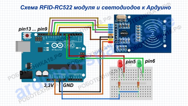

rfid-led
when i connect the right key the current goes to output 6 then to output 5 but i need the current to go only to output 6
I want the current not to go to pin 5 when I apply the correct key

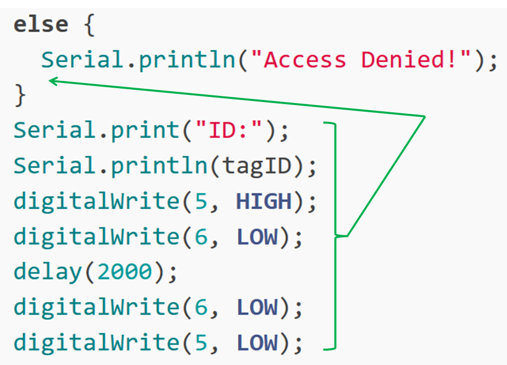

Sorry, but I can't explain in detail what I wanted because the translator doesn't translate correctly, but what you posted in the first post in the photo worked.
So as others can make sense of the discussion about the photo:
This is the image I deleted, along with the question "Does it do what you want if you change the code like this?"
