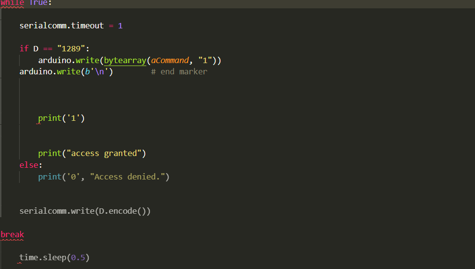

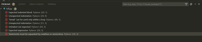

I am getting an error:
This code is fine but this one is not working:
Ok I fixed that problem but I am getting loads of error plz check my code:

The forum broke it down a bit so ignore the broken parts. Anyways here are the errors:
And here is the code in a png format:
Please post with code tags don’t post picture of text
➜ please read How to get the best out of this forum and modify your post accordingly
