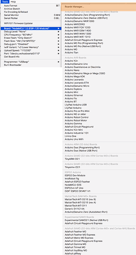

and i set on Arduino in File/Preferences Show verbose output during compilation
and after compile i can see directory where arduino ide have temporary file for extract elf file

There is an ESP8266 "board" add-on for Arduino that includes an "Arduino Compiler" which produces ESP8266 code.
There are "boards" that add compilers for ARM, MIPS (PIC32 - Chipkit), MSP430 (TI Launchpad), ESP8266, ESP32, ARC (Arduino/Intel 101), and x86 (Gallileo, Edison.) Perhaps more.

The "board" menu of the Arduino IDE lets you select from one of the installed "boards" (like "Arduino/Genuino Uno" or "Adafruit ESP32 Feather"), and also includes a "Board Manager" choice that allows you to add additional boards that have been prepare by 3rd parties. Many of the boards that used to offer "an Arduino-like IDE" (ChipKit, Launchpad, Maple) have switched over to offering a "board manager" package for the standard IDE instead.
It's an amazing feature - one of the big successes of the Arduino team in the last few years.
