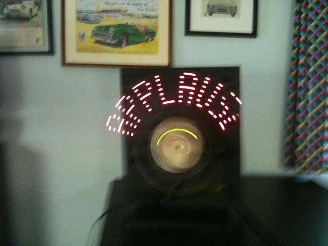

HELP! Can't find bugs in the code of my POV (mirrored display)
Hello! I need help in debugging the code for my POV.
It displays right string but it is mirrored :frowning:
check this:
that's my output.
I got the codes from here:
I already edit the for loops of the code. please take a look, it is quite short.

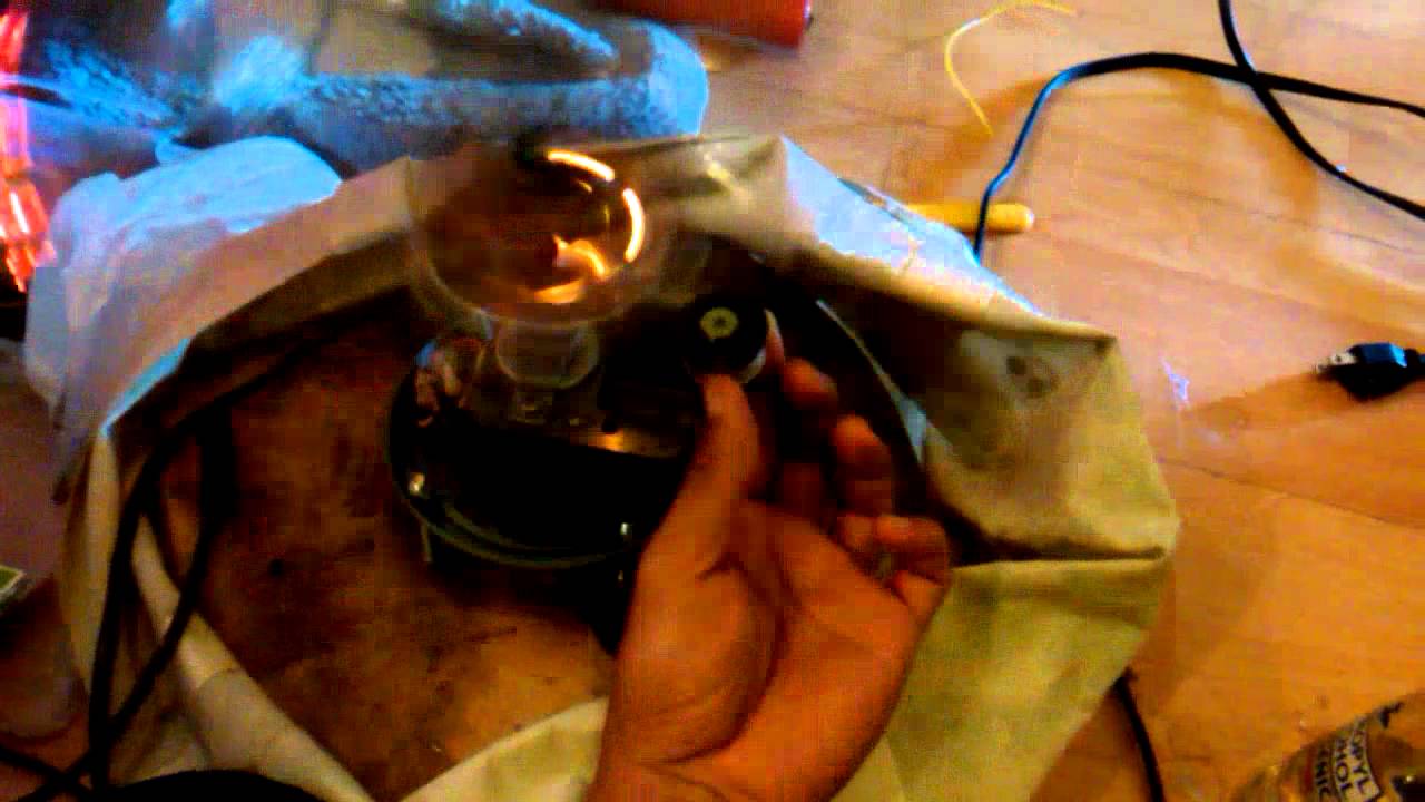

PS: The code was originally written for bikes, (I made one last last year)
and my project (as you can see in the video) is designed vertically. Globe Design.

right now, the display is not mirrored, I swapped the first and last hex digit of letter L and letter P and letter E inside the font.h
my last problem is this: the display is still reversed. I mean this:
ESUALPPA <-- it should be APPLAUSE.
I wonder how to output that in reversed order. :frowning:

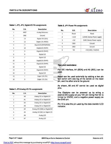

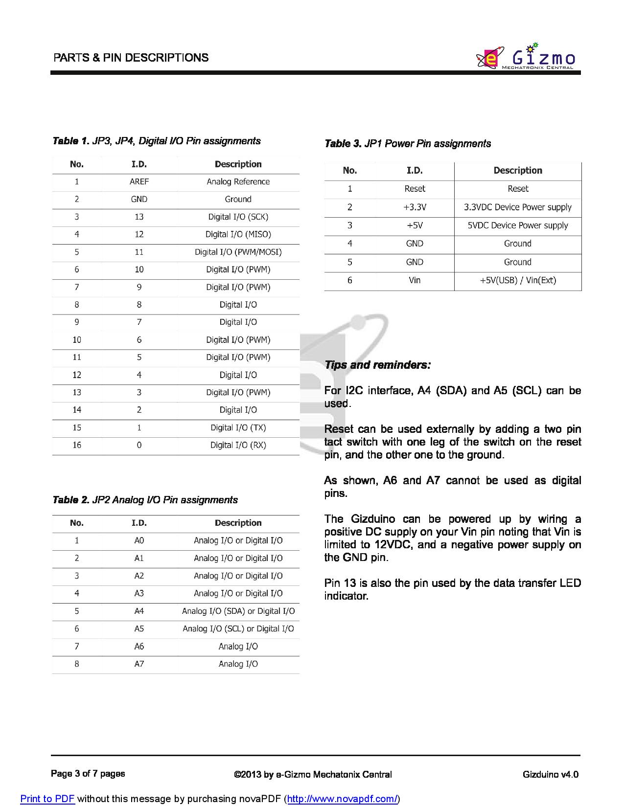

For your reference here i am attaching the Image of the pinout.
I could not able to see
I already transferred the sensor to pin 14 (analog) then use an analogRead();
You being mentioning here.
A0 -A7 are the Analog pins
