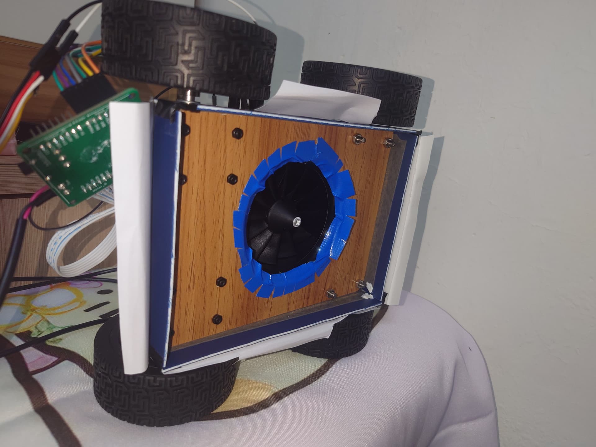

Hi guys, I really need some help with my wall climbing machine project. For the past few months, I have changed the design again and again, but I still failed. Please tell me some ways or methodologies to make it work. Here are some photos of my current design.

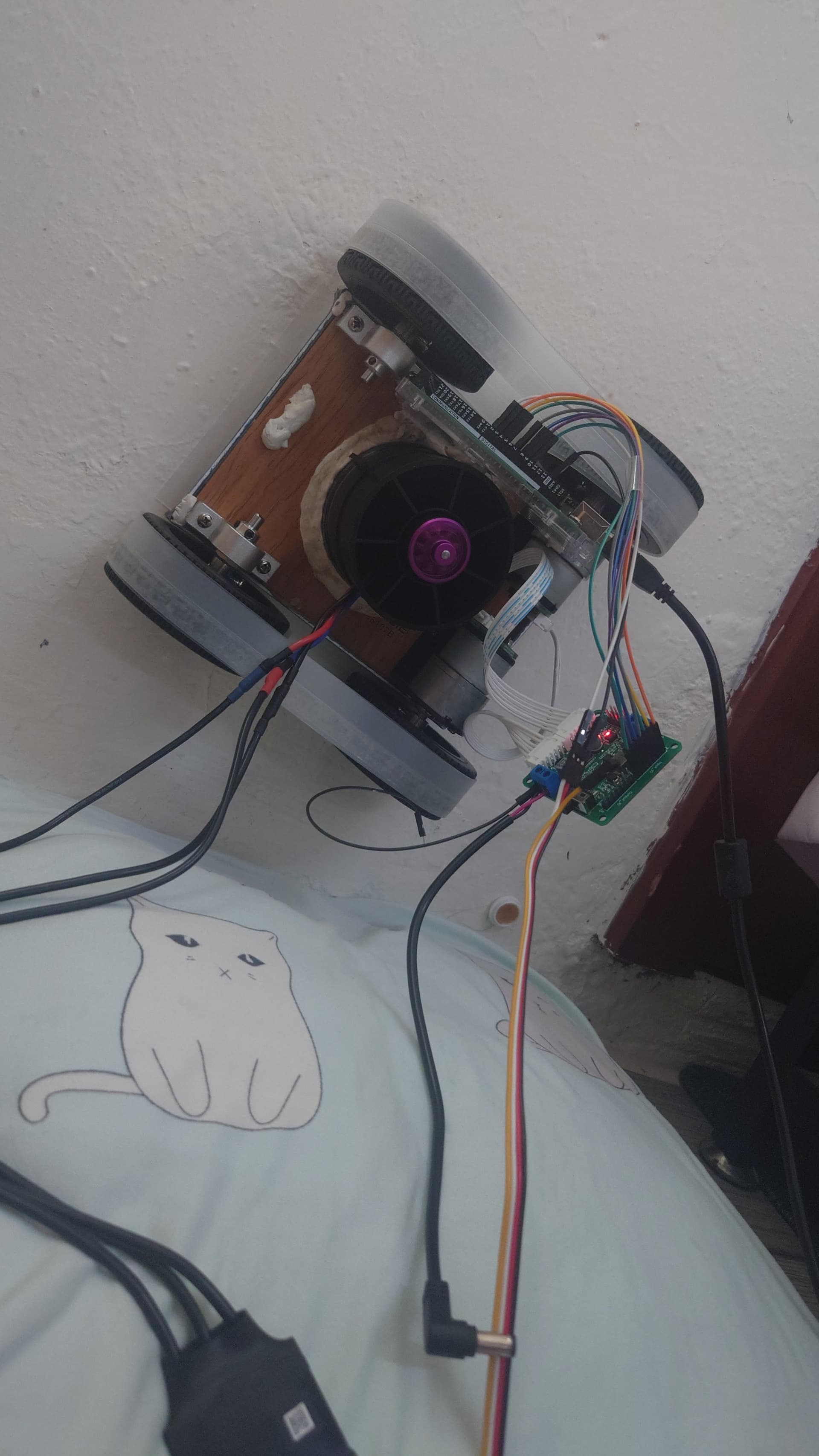

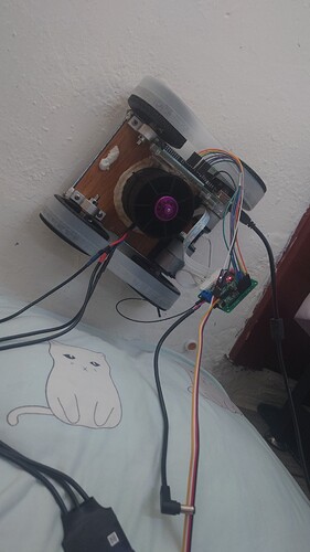

So, the machine "sticks" to the wall by using the fan in the middle to pull air out, creating a low-pressure area beneath the robot. The blue rectangular space acts as the low-pressure chamber. The two motors are for controlling the wheels. During operation, I have two major problems right now: 1. The machine slips when it is vertical. As one of the photos shows, the machine can "stick" sideways, but the wheel will spin, and the machine slips when it is vertical. I think the reason is that there is not enough normal force and/or friction. I tried to wrap the two wheels with a handmade plastic belt, but it still wouldn't work. 2. High throttle is needed. I am using around 90% throttle to make the machine even possible to work, which means either my fan is not strong enough or the efficiency is very bad.
Here are some specs for the machine if it helps. The total weight is around 1.3kg (the wheels motors are very heavy tbh), and the EDF fan is 70mm 6S 2300KV with a full thrust of around 2.2k grams. The pressure chamber is 17.5cm long, 13cm wide and 2cm tall. The air gap between the pressure chamber and the wall is 1mm. I have seen designs with way heavier weight and weaker fan, yet his works fine, but mine doesn't (ref: https://www.youtube.com/watch?v=0UTFLwNDz0c).

Get the car to stick onto a plank of wood, than add weights to the wood till it falls off. Calculate the total weight of the plank + weights. This should give you an idea of whether it is the fan at fault. If the weight of the car is greater than the total weight of the plank + weights, then we have a problem. Also don't worry if you get varying results from the video you have referred, since even tiny unknown differences can affect your result

All other things being equal, which is probably not true anyway, the major factor as to whether the robot is able to hang on the wall and move is probably the coefficient of friction between the tyres and the wall
That being the case, the OP needs to concentrate on that component. The picture shows wheels with a tread pattern. Change to a completely smooth tire surface. Next change the material to a soft foam material. Tell us the results.
A free-body diagram shows that the major factors are:
  • suction force (which may be increased by a more powerful fan, smaller gap between wall and skirt, and larger "sucked" area)
  • weight (which may be reduced by judicious choice of materials)
  • coefficient of friction between the wheels and wall (which also may be increased by judicious choice of materials; and note that for practical purposes, the friction force is not a function of contact area)
  • perpendicular distance from the c.g. to the wall (counterintuitively, the larger this distance, the better, up to a point, since it "directs" more of the suction force to the lower driving wheels)
  • wheelbase (and likewise the smaller this distance, the better, to a point...)
