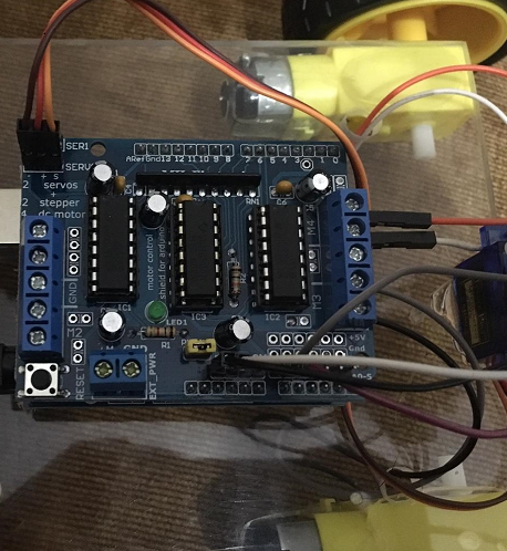

Hey guys,
i wanna do Obstacle Robot add photo at attachment. I used L293D Motor Driver Shield,HC-SR04 sensor,2 piece DC motor 9v and servo motor.
I try to just 2 piece dc motor is working and servo motor.
I wrote code but My servo motor is turnnig just. Someone help me ? Chek my connection and my code ??

This confuses me.
Please remember to use code tags when posting code
This can't be right:
else if (distance >= distanceRight ) {
turnRight();
else if(distance >= distanceRight){
  turnLeft();
And your functions lookLeft, lookRight don't look at anything, they just move the servo about. And they return distance which isn't ever changed in the functions - so what's the point?
